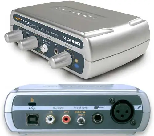

There are no Preamps installed on the Mic channel of the fast track USB.
I would completley recommend Pluging your mic into your mixer..........Behringer doesn't get the credit they deserve..........yea its not top of the line Mackie stuff.........but if you are new to recording Behringer is the way to go............I dont know about you guys........... but i dont have hundreds of dollars just laying around that i can spend on expensive top of the line mixers.
What?? That's dead wrong, of course there's a preamp on the FastTrack! The pic you posted, what do you think you plug the mic into, that's EXACTLY what it is! There wouldn't be an XLR mic jack if there was no pre behind it.. There's 1-4 mic pre's depending on which FastTrack he has. And I'm not knocking Behry, I got tons of it myself, I'm not rich either.. But the M-audio pre's are NO DOUBT better than behry's. I want to know why the you think he ought to have a mixer in the middle of the chain, when all it can do is add more noise to the equation.
The ONLY setup that includes that mixer should be if the OP has the FastTrack Ultra USB 2.0 - there's 4 mic pre's and 2 line-in's. He could achieve 6-track recording with the mixer on the 2 line-in's. Otherwise the other 2 FastTrack models have a mic pre for each channel, and you should definitely use them.

Any device that has an xlr jack made to plug in a mic has a preamp. Some pre's are noisy and hissy, some are clean. M-audio has fantastic pre's, nothing in the price range can touch em. Behry pre's are notoriously hissy. I've used both, they're worlds apart in SQ.
