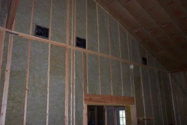

What's interesting, is that the literature states the dimension of the Roxul for wood studs on 16" centers to be 15-1/4".
When I was installing the rockwool in my studio, the studs are 16" on center - so that makes an inside dimension of 14-1/2", but the RocKWool comes in 16" widths.
I had to trim about 1" off of EVERY SINGLE PIECE I installed! :mad:
Looks like these guys have taken that into account and done that for you!
Looks like a great product. I'm sure it'll work out fine.
RockWool in the Live Room:
Man that's a huge room.
I just have to figure out a way to put them in my corners now. I was thinking of puting wood frames on each side wall 24" from the corner then cuting the insulation and stacking it on it's side stacked up on each other from floor to ceiling and covering them with cloth.
Think that would work ok ?
