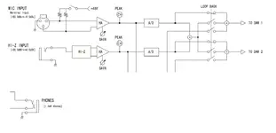

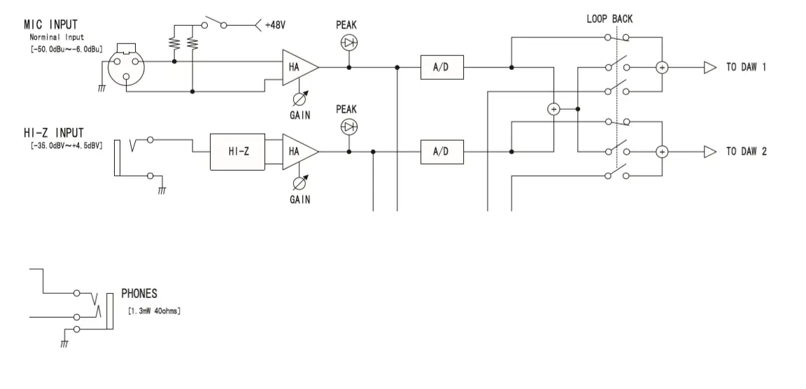

the manual shows the preamp as -50dbu ~ -6.
+48v...… headphones 40ohm, so typical closed backs of headphones shouldn't be a problem.
Can you try another mic, easily?
that might determine if its the UR12 or the Mic or cable.
