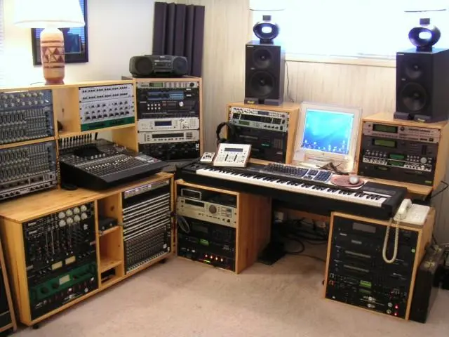

Here is a picture of the racks I built for my studio. The only one I didn't build is the slant rack in the corner with the boom box on top.
Splooge.... Everything about that picture is awesome, racks included. Absolutely beautiful, S.Albert.
And AcidRock, yours looks pretty darn nice too.
