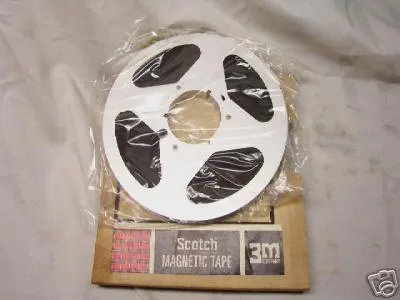

Hiya,
I have this exact tape, it's 60's / 70s, and I want to use it with my 80-8,
however I am not sure if it will work.
My 80-8 is set up for 456, and I'm not sure what this scotch 3M tape is set up for. Can anyone help?
Thanks.
Supertramp

The boxes and reels all look alike from a distance. Are there any numbers on the box that might be a model number; 250, 206, etc?
Whatever it is it may be sticky.
Ok if you purchased this tape second hand the the first thing you need to do is this.
1. check to see if there is leader tape on both ends.
2. check to see if there are any joins or splices in the tape (you will have to run this tape through a machine to check).
Also on the front of the box there is commonly a number.
On the scotch 3M tapes i have which are 7" reels the number 215
I don't have 3M 10.5" tape reels yet, but i will be getting some more soon.
Hope this info helps
Keith

Throw the tape away and keep the reel... if it’s straight. 203 is old and crappy. Best to buy new Quantegy 456 or RMGI SM911 for your 80-8.
The operating level of 203 is more than 6 dB down from 456. But that’s really a moot point, because it will likely fall apart if you try to use it.
~Tim

Model #: 203
Est. Yr. Intr'd: 1962
Binder type: C
Color: black
Base mat'l.: polyester
Base thickness: 0.92 mil
Oxide thickness: 0.51 mil
Total thickness: 1.43 mil
Backcoated: no
Remanence: 0.64 flux lines
Coercivity: 315 Oersteds
Retentivity: 790 Gauss
As opposed to this!
Model #: 226
Est. Yr. Intr'd: 1979
Binder type: H
Color: brown
Base thickness: 1.3 mil
Oxide thickness: 0.56 mil
Total thickness: 1.94 mil
Backcoated: yes
Remanence: 1.25 flux lines
Coercivity: 360 Oersteds
Retentivity: 1400 Gauss
Conclusion!
203 is distinguishably inferior to 226, (which is compatible with 456). It's a 1 mil tape & is probably 3600'/reel.
It's your Grandpa's hifi audio tape, but by today's standards it's not quite that. I'd say use it, anyway, but I'd not recalibrate for it. Just run it 6db down, and make the best of it.
Good luck!

Here is some more info I found on the box (I don't know how I missed it):
Scotch 3M 203
760-0926-004
203 1/2" 3600' (12.70 mm -1100 meter)
So this is in fact tape with a level of 185nW/m 0db?
man, thanks for all the help!!!!

This topic question is confusing. It's like going to a Chevron gas station and asking the attendant for a list of engines the gas is rated to work with.
The tape is simply tape. Reference levels for tape...any tape...are a function of what that hunk of wires-circuit cards-heads-transistors want ...your tape recorder.
Your tape recorder was built to slap signals on tape based on certain characteristics. The test tape you buy from MRL etc is matched to your machine's electrical requirements.
With your machine...and test tape rated for your machine...you then buy any old reel of tape you want and simply run the calibration tape to set up the levels with that particular reel of blank tape. When you go out and buy some other brand of tape, you then slap on your MRL test tape and do the machine calibration all over again to get the best signal out of THAT tape.
At no time during the process does the machine...or the test tape...ask or care about any technical specs for the blank reel of tape.
There was a (imo) goofy concept invented a few decades ago that was designed by marketing guys to hype the tape biz. The concept invented was elevated levels. There are a few folks still alive roaming the planet that actually care about calibrating to take advantage of an extra 3 or 6db of headroom that's never needed anyway...but...for me, it's a non-issue.
As far as that old tape you're speaking of...it's also a non issue as the elevated-level tape marketing concept wasn't even invented back in those days.
Bottom line...any tape will "work". You own a test tape right? (and not a copy of a test tape). The test tape is the ONLY animal that is calibrated to certain specs...specs your machine requires.
The brand of blank tape is irrelevant...except to whether your ears decide after calibration that you like that particular tape for whatever "sound" it gives you after you record on it.

It does not have a backcoating and therefore will not have sticky-shed per se. I’m not referring to sticky-shed, but rather normal shedding on these older tapes, which can be pretty bad and gum up the works.
We’re talking about best practices here. Unless you’re trying to recover old recordings from a tape like this there are no sound reasons (no pun intended) to record new material on it, save maybe some sentimental reason to use a certain tape. The results will disappoint.
Tape is not tape. The advancements in tape formulations over the decades have made a phenomenal difference in the quality of analog audio. Nothing from the early 1960s can hold a candle to modern tape. Those with elevated levels… +3, +6 and later +9 were born from ongoing research and development of several manufacturers to improve the medium. The more signal a tape can absorb and hold, the further the audio is from the noise floor of the tape. All tapes have a saturation point where no more signal can be absorbed. No matter how hard you hit it the playback will still be only so far from the noise floor. In signal-to-noise terms, 6 dB is a huge gain.
The magnetic particles of modern tape are finer, and therefore more densely populate the tape surface. Frequency response is better, distortion specs are better, noise is lower and dropouts are fewer. The coating is smoother and more consistent. Backcoating improves tape handling, reducing wow and flutter.
The oldest 3M tape that I would consider modern and usable is No. 206 (1969) but more probably No. 250 (1974). No. 226 (1979) is the 3M equivalent to Ampex/Quantegy 456.
For best results Quantegy 456 or equivalent tape is recommended. If getting the most out of your 80-8 is not your primary objective, then tape doesn’t matter. If you’re just having fun and experimenting there’s nothing wrong with that either.
