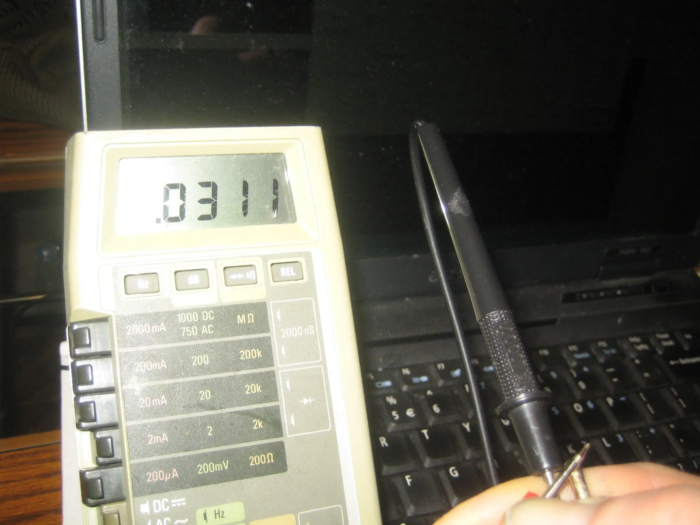

Here's a picture of the meter reading.
But........is this right.??? It reads .0311
I just noticed this. Im guessing this is different from 0.311. :o
Alrighty then!
Well I was reading this thing wrong! Obviously:o

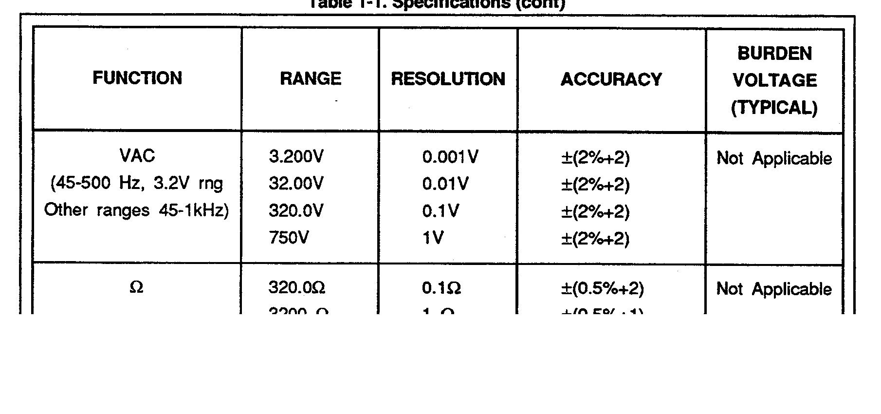

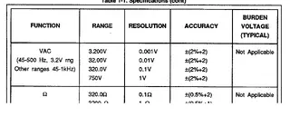

Can anyone tell me by this spec if my Fluke 77 Series II meter has "true RMS" capable readings?
I can't figure it out, however I notice a slight dip in reading higher frequencies in use. In the turnaround I use mostly 1K signals on critical adjustments. :/
Thanks
My reading is it's accurate only to 1kHz, and not spec'd for accuracy beyond that, which is why my high frequency readings vary a little lower. :/
