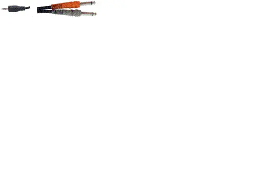

so will this work?
so will this one work???...but what about stereo?
Yes, but you will only get signal to the left or right side of the soundcard at once.
If you end up getting a mixer with left and right outputs that cable will be a better match.
