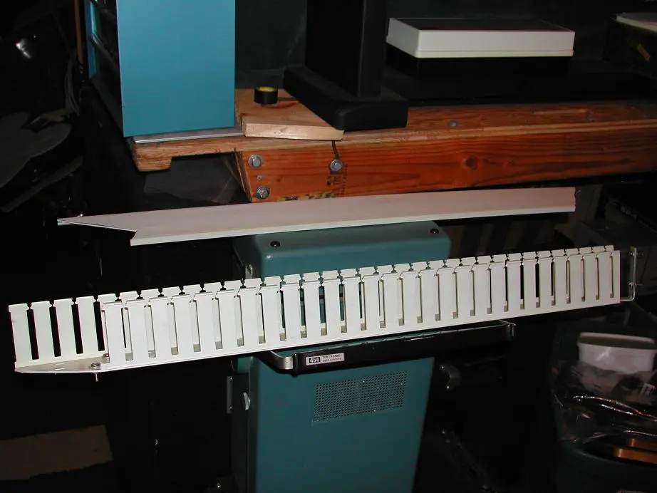

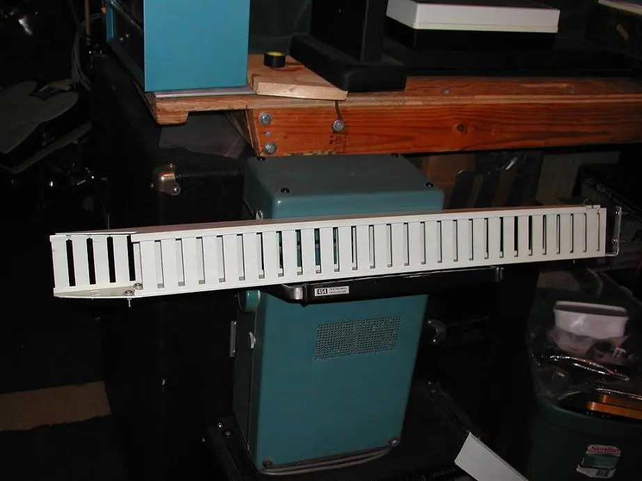

Clever, and cheaper than this stuff (about $4/foot)
With the lid off -

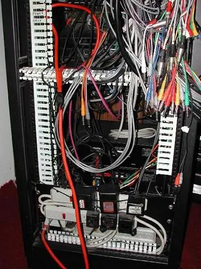

Semi-derelict rack showing application -
Yeah, but Knightfly's has the advantage of all those little plastic fingers you can use alternatively as cable hangars on the back of your rack (I wonder if they have enough resilience to buzz if you pull one back and release it, kinda like that old instrument I can only think of as a Jew's harp).
Darryl.....
Darryl, you've just discovered the secret of my "high frequency multi-band panel resonator" - shhhhh... don't have it patented yet... :=)

That stuff is probably the best solution, but like you said, its about four bucks a foot. Whats nice is you don't need any ties at all, and its flexible enough that a fat snake cable can get through it.
Cool!
Whats with the cheapo cascaded power strips? :(
Two of these up the back sides of the rack will do nicely:
http://cgi.ebay.com/ws/eBayISAPI.dll?ViewItem&item=2965035478&category=3319
Or if you like wasting "U" space front or back:
http://cgi.ebay.com/ws/eBayISAPI.dll?ViewItem&item=3059153348&category=20315
When it comes time to load my racks closer to the end of the year I'll make sure I take more pictures than I normally do so everyone can see how I do it, what I use, etc. Its the one thing in my studio that will be extremely neat. The spackle... well...
I'll keep it quiet for now, but with pictures on a public forum, man I just don't know how long I can manage to keep the lid on it!!
Darryl.....
p.s. Frederic - I went out looking for one of those 48" strips like you showed last weekend for my room, but Lowe's wanted something like $40 for one, and on the same aisle they had the 6-outlet strips for $2.99, so you can guess which one wound up in my studio (el cheapo man that I am).

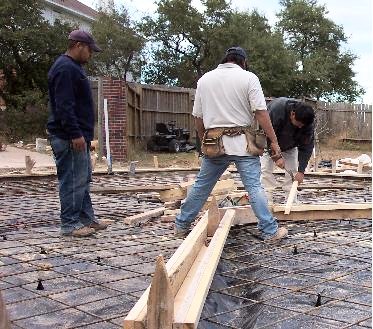

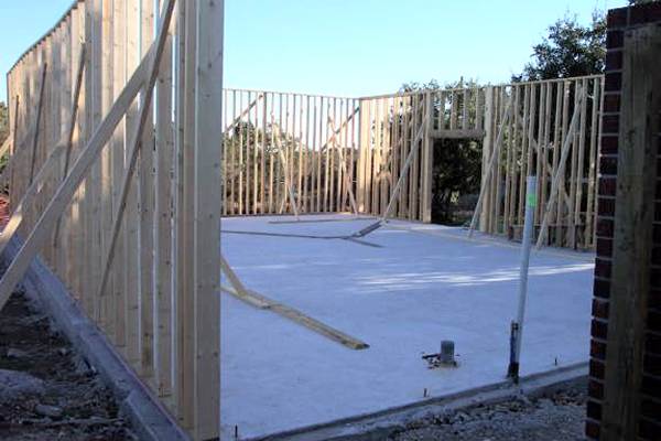

Me either.
So plan it all out, and have the foundation contractor form up channels before the slab is poured.
Then when it all starts to come together,
you're set!
and all you have to do is keep 'em neat inside the console/rack.
Too late for that... floor already exists.... but part of my floor will be built up for a 'tiered' effect (thanks to John Sayers and a cool design he did)... so I might be able to sneak things under parts of the tier.
(Thanks for the pics Michael... just reminding me that I'll NEVER be satisfied until I take over your studio ;P )
