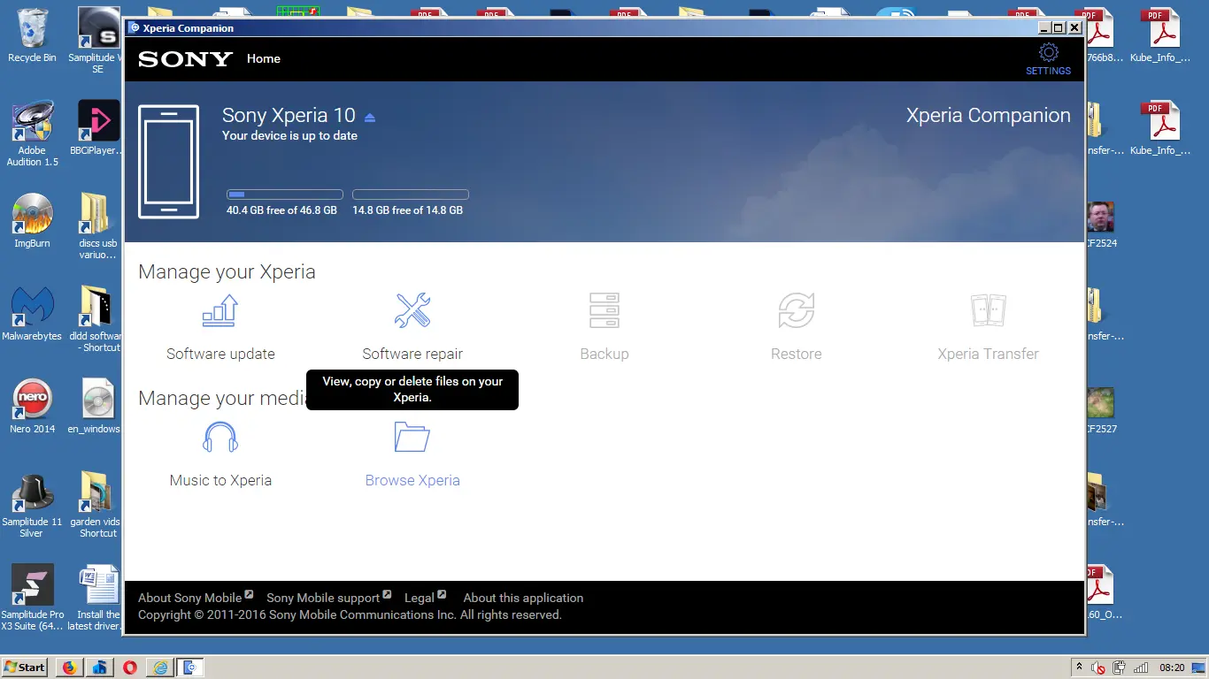

See attached. I have just plugged a USB A to C cable into the USB 3.0 port of my (old!) W7 i3 HP laptop and I can accesss files on the SIM card or the memory SDC card.
That software program comes from Sony, cannot see Samsung not doing similar?
Oh and the USB port charges the phone the while.
