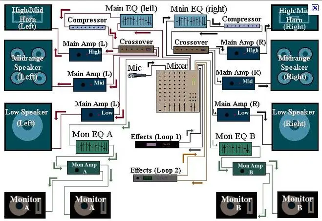

Well I already have the mic stand, just need the XLR cable and will soon have the mic in hand... But I don't understand in what I'll be plugging it in... Can you guys explain the schematic behind the use of this equipment? What I mean is... You plug the mic into (???) And that (???) is plugged into the (???) and so the sound comes out of the speakers.

Schematic for you. :D Small sound system diagram

Secondly, thanks for schematic but it doesn't open up when I click the link :confused:

Sorry about the link. Weird. Cant get it very large so included another here. The big one is a bit more elaborate but gets the point across.
