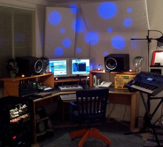

wassup? I had a lot of problems with standing waves in my new apartment, so I just built my own wall panels. Its basically fiberglass on wood, with white curtains wrapped around so it blends into the walls (a requirement from my fiance). Now the room sounds siginificantly better!! Ahh, and the blue dots are from a light installation under the ceiling from accross the room (for the "vibe").
Just thought I'll share my joy :D

Very nice.
Now when are you gonna get those monitors out of the corner?
Yeah, you should - I did a crude ray trace of a room I was considering for a while - ergonomically, putting the desk in the corner was a good idea in that case, but acoustically it's about the worst place you can be.
In order for there NOT to be serious early reflection problems, it would have taken 'way too much absorbent in the room to keep any live feel whatever - it needed 4-6 inches of 703 across the corner behind the desk, also extending that corner absorbtion along each front wall (front as in, the direction you face when mixing) and then the entire two rear walls absorbed with more corner traps - this, in addition to ceiling absorption, having to cover windows (more reflections to wrong places), and I finally ended up scrapping the project til I can come up with a decent ergonomic NOT in a corner...
Geometrically, any sound you "fire" into a square corner, will be reflected back exactly parallel to the arriving sound - so any square corner will be a mass of unwanted reflections at a wide range of frequencies, which is likely the main reason why placing absorbent across corners does so much to clean up a room.
I was going to post a copy of my "geometry lesson", but apparently I haven't yet converted it to jpg from the cad format - main thing, though, is C7's right - corners aren't a good place for a mix setup... Steve

I am aware that placing the monitors in the corner is far from ideal. However, since I live in a rented apartment and I don't have a lot of space, it was the only solution to keep my studio. The wall panels help solving the problems so some extent. though. Also, I'd never get a 90 degree desk again, coz it limits monitor placement too much. Guess I have learned my lesson.
I didn't say you couldn't make it better - if you're up for it, just making the mix position more symmetrical acoustically would help a lot. If you could do two more panels like the lower and upper ones you have behind the right monitor, in front of that window, for example - you could maybe do the upper (sloped) one fixed, and if you like, do a "gobo" type panel that's removable for in front of the window - you'd only need it there when mixing, so you have more balanced response coming back from both speakers -

Im going to disagree with this. In a square room you need to move your mix postion away from the center of the room and get rid of as much parallelism as possible. In a square room thats treated the best place is usually the corner. I was involved with this type of discussion before with Bob Katz, Bob Olhsson and even John Sayers. If the room was not square or really large then the corner is less optium. Notice that the monitors are not really in the corner but perpendicular to the walls. The monitors should be closer together with then sitting up instead of their sides. Sometimes putting the monitors close to a wall can give you a faux sub woofer if your careful about learning how they translate. It would be important to bass trap the corner behind the mix position as well or a gobo tht you can move around behind you.

I think there is an old TapeOp article where Eddie Ciletti did this for his square-ish room. Or at least he talked about it at the first TapeOp conference. If you're in a small, square room I think it makes sense to be in the corner. Otherwise, the corner is probably one of the worst places to be. You should try to make the treatments symmetric though.
SoMM, the key word here is "treated" - without it, there is NO good place to be in a square room IMO - with it, I agree that a corner setup can work as good as anything in a small room. My original study showed that front wall early reflections were easier to take care of in the corner, directly behind the mix desk was actually better that way (4" 703/705 across the corner, directly behind the desk, for bass trapping and smoothing out SBIR on the front walls (stood off 4" extending the corner treatment, out another 4' or so) - then, the rest of the two front walls can be live but cross-fire from the speakers will require about half of each rear wall to be absorbed (at least for the middle third of their height) in order to control less than 22ms reflections off the rear.
It seemed possible to get a decent sound out of such an orientation, but not without serious thought as to treatment location/amount. I will still very likely end up doing that project, but have a few ahead of it in the list (finishing a drainage system, new roof/siding on house, new 40 x 60 shop) so probably won't get to this one til next year, when my old studio will be gutted and become part of a general 36 x 48 storage building (now a small shop and studio, but definitlely NOT sound proof by any stretch of the imagination)
