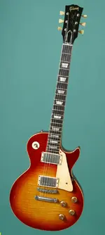

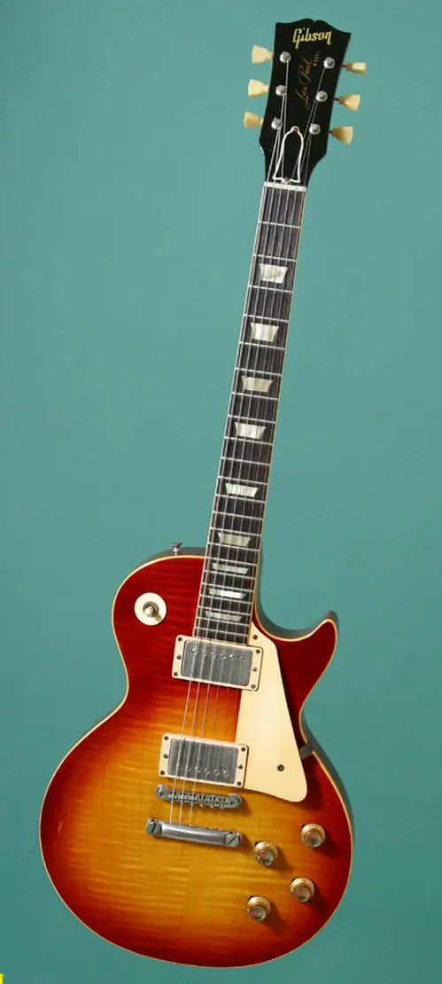

Light,you are misunderstanding me.I'm not talking about the tilt of the headstock.I am talking about the angle of the D and G string between
nut and tuner.(Imagine the guitar on a stand facing you.The d string
take a very hard angle to the left from nut to tuner and the G does
the same to the right.
Anyone that thinks this would not cause tuning issues has not thought
it out.Most les pauls go sharp on these 2 strings when you bend them
hard.That is a problem at the nut and is is caused by that drastic angle.

I knew exactly what you were referring to but the geometry of the strings between the D and G string will not and does not cause the strings to come out of tune period.
Light is dead on the money with his comment... "For what it is worth, the main reason most non-trem guitars have tuning problems is simple operator error..."
A PRS custom 24 and other guitars like a Fender Stratocaster with tremelo bridges is more likely to come out of tune due to string stretch from using the tremelo bar.
A Les Paul design is a lot less likeley than the above mentioned to come out of tune under normal playing conditions.
besides that look at all of the guitars on the market (both Acoustic and electric and lets not leave out Bass guitars either) that has the exact same headstock configuration as a Les Paul which do not come out of tune.
sorry dude but the only thing out of tune here is your theroy.

Most acoustics dont get the strings yanked on like an electric and are strung
with heavier gage strings.As for guitars fashioned exactly like an L.P., I've had the same probs with those as well.
I got rid of my last L.P. pronto because it was useless on stage.Looked good
and sounded fantastic but the G and D would go sharp everytime they were
bent.
BTW,my strat has a stock tremelo(floating) and a stock nut.I can dive bomb
that fucker to the body and still play 2 sets w/o having to tune it.
Go to any L.P. forum and "tuning problems" will be the title of more than a few threads.
Anyone that would argue that having more friction at the nut is a good thing
is not thinking it thru.

I hate to perpetuate the thread highjacking but,
Think about what you're saying. If your diagnosis of the problem were true, how did Chuck Berry stand it? Your argument would say that the 335, SG, Les Paul, and many other Gibson models, as well as a host of others based on them, have a basic design flaw that makes them unusable for stage work. Do you really buy that?
I suspect that you're problem was at the nut. This is especially true if your experience was with '70s instruments with that micarta nut material they often used at the time. But either way, those angles aren't sufficient by themselves to cause the string to bind.
By the way, how is it that you go sharp after a bend if something is binding?
