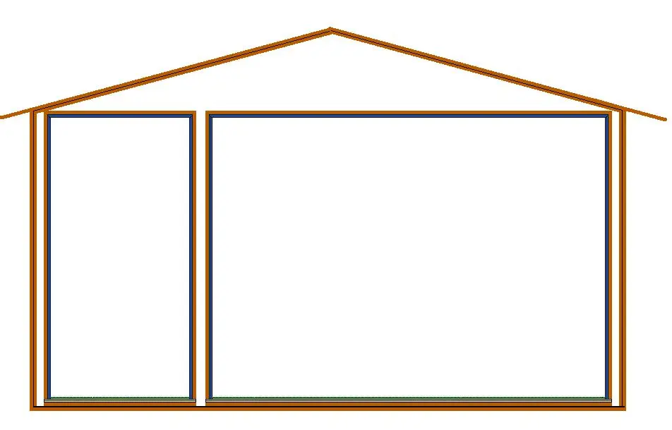

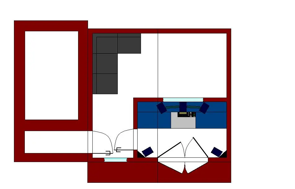

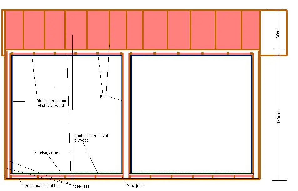

I'm actually planning on the same kindof idea. The only benifit i have is my WW1 air-raid/bomb shelter. I'm planning on the same sort of size and planning on partitioning the shed/summerhouse into two rooms. I think i will have a floating floor: 2x4s laid on r10 rubber(on the original wooden floor), with rockwoll between each joist, and two layers of chipboard; and a stud wall partition with two layers of drywall with rockwool insulation. I'll give you my plans. I'm no expert, actually i'm just a 17 year old kid with an idea. But I've read a bit and think it should work. If there is any reason why it wouldn't could someone please tell me,
Thanks,
Pandamonk

The idea of a separate tuff-shed for the control room is a good one, way better than trying to get isolation in a partition.
I would look toward somehow trying to float a fllor above the one that is provided by the shed. also look at the window as the one that they will provide will most likely be a big sound hole.
Also look at the door, both in terms of the seals and the construction. Try to make it a mass-air-mass construction as good as the wall with two seals.
Finally, while they say you don't have to pour a slab I can't think of a better way to insure that you have a solid and level surface to build on.
