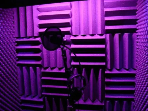

I have a booth that is 4x4x7. I built it out of 4'x8' sheets of particle board.
It was originally hinged together but now is screwed together with hinged door.
I used cheap foambymail foam on the inside.
Here are the pros and cons...
Pros: It looks pretty and does a pretty good job at keeping sound in and unwanted sounds out.
Cons: It's heavy and sounds like crap.
I am going to tear it down and treat my entire room with Panels OC703.

BTW, My foam is black. I used Pink and purple cold cathodes for lighting. (No heat whatsoever)

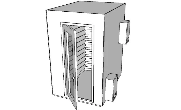

4'x5'x7' would be a good size. use a slat resonator wall to angle it and provide low-mid treatment. this design is roughly that and (in theory) you could build it to pull it apart (use rubber seals and pin hinges) by making each wall a separate assembly. in the attached sketchup file, i remove the track light and fan (in silencer boxes) components to make the file small enough to fit...
  • 4x5 vox booth.zip
    4x5 vox booth.zip
