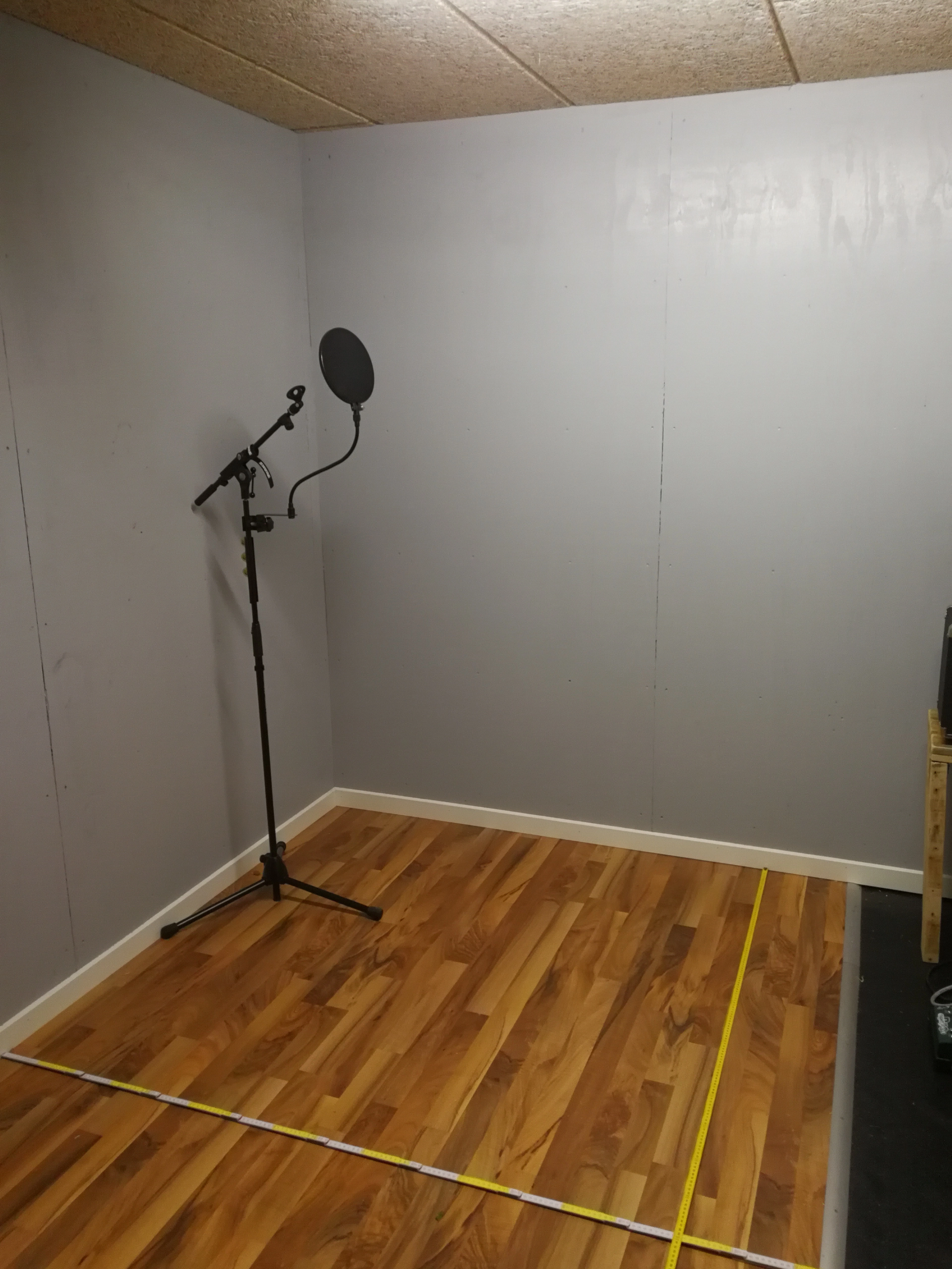

To give a better understanding, here is a pic of the room:
The rulers was just to see how much 5'x5' would look like..
drive.google.com/open?id=0B_oPpMEBrQ9rM1VteTAtbHRWeEU

Your dimensional mockup only considered 1 wall in each direction, if you have 5" thick walls (which probably are not enough to block ALL sound), then 2 walls (left and right, back and front) = 10", so you're going to be down to 4'8" x 5"2". If the inside walls are left as cloth, then whatever insulation (rockwool, pink stuff, whatever) will do some abosrption inside, but if you have any kind of hard surface inside (sheetrock, wood), then you are going to need trapping inside to deaden it more. A small room like this might be ok for voiceovers, but not for singing.
