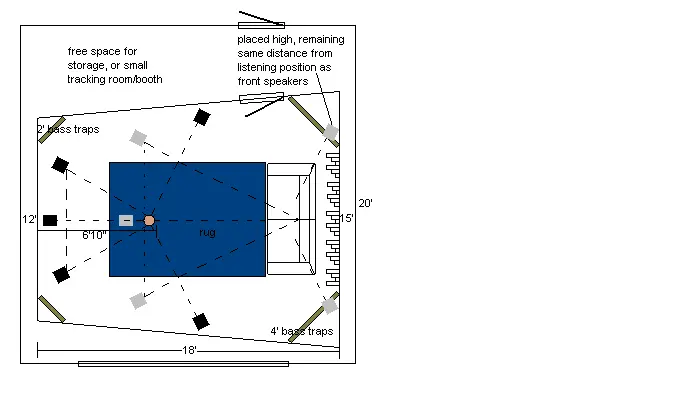

One thing you could do, is have a reflective floor with a big rug. Roll it up when using the room for the studio and leave it in a corner(floor>wall corner) and it should absorb more bass than it would spread out. When using the room as a home theatre, simply roll it out, and you have a HF floor first reflection absorber.
Have a look at John Sayers designs, and you will see almost all his control rooms have a trapezoidal shape. The backs of the rooms have bass absorbers which distract from the trapeze shape, but the basic shape is that.
K i'm drawing up a quick diagram. I'd recommend a different monitor setup for mixing a home theatre, unless you wanna have to move them about every time you use one or the other. If for nothing more but to give you reference. The grey are theatre and black are studio. Hope you are able to decipher it. Now it's time for my bed.

wow, thanks for taking the time to do that!
that looks like a great layout concept - and the idea of an area rug never ocurred to me... that's a great idea. not to mention the storage space is a bonus. my girlfriend said she needs to be able to store her shovel. shovel? still haven't figured out why she needs a shovel. not like it snows here...
anyways...
i'd pretty much come to the conclusion that i'd need two monitor setups, so that's a good call.
really appreciate your thoughts on this... looks like i have some decisions to make here. =)

Glad you appreciate/like it. I'm not sure of the angles, but i think it needs to be at least 1" every 1', if you get what i mean. Definitely check up on that before you build.
I'd also put that design past other people, especially over at john sayers, to get it checked out/refined. I'm more used to giving basic suggestions on existing rectangular rooms.
Remember, I'm not a pro or anything, just an amature who's read up on acoustics quite a lot. Loads would say i'm still a kid, 20. I will be professional soon, acoustics is a part of my new business, although i'm nothing close to being an expert.
