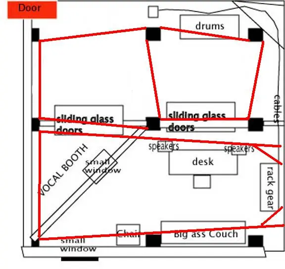

Here is the deal. My band just happened upon a frickin HUGE fallout shelter in between Chicago and Milwaukee. It is a huge space with concrete floors walls and celings. there are cement pillars every 15 feet square. Its big enough to be a roller rink or indoor skatepark! The celings are about 12 feet high. The landlord told us he is not going to be using the space for 2 years. So we have a place to record and practice for 2 years. The problem!! Its is so big and there is so much reverb that we cant practice or record. SO... I want to build a recording space with a control room for as little money as possible. so i need ideas from you guys as how to go about it. I was think of a layout based on this picture.
https://img439.imageshack.us/my.php?image=untitled12pj.jpg
This would be in the corner of the room using the two exsisting cement walls. and building the other walls. The black squares represent the pillars.
OK... With all that said. We really have no money so we need to build this on the cheap..really cheap.. any ideas on tricks and techniques or better ideas for layout would be appreciated. I am going to the space this week and will post some real pictures..Thanks in advance for your responce

Ian,
the layout is a bad one - the control room needs to be symmetrical - if it isn't you will not have proper stereo imaging during mixdown.
You need to redesign it, keeping that in mind.
Rod

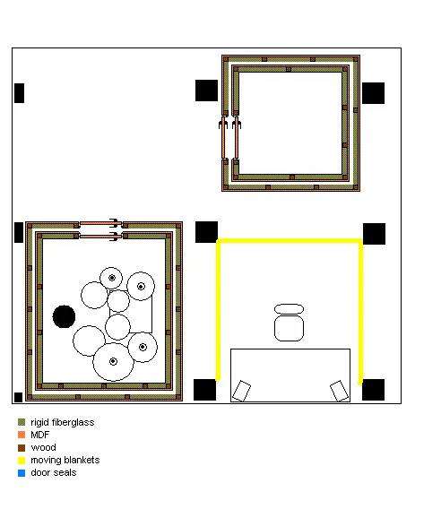

What i'd do with that room and a $1500 budget is build 2 booths. 1 for drums, and 1 for everything else. Or maybe even just one booth. I'd build it in such a way, that it can be easily taken down without damage and used elsewhere. Then i'd hang moving blankets around the mixing position. Check the attached pic.
How about this...

Here's my two cents worth. Considering your budget, I didn't include windows for the drum and vocal booths.
