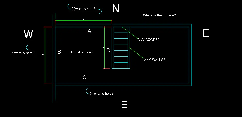

OK i cleaned out the space today and the measurements are 10x9x8
i wanted to draw out the plan but i cant draw well with a mouse. so i made a list of things you should no

Well, untill we know exactly what we are dealing with it makes no sense to even go there yet. In the mean time, I'm going to post a drawing of your basement for you to correct, since you say you can't draw with a mouse. Although, even a simple floor plan done in MS paint would help a lot. Show the space, stairs, furnace etc, and give dimensions( measure each thing and punch in the dimensions by hand in the drawing. This is REAL important.
Or if you have a digital camera, post some pics of the space but that still don't give me dimensions. Untill then, here is a drawing for you to correct. I am totally guessing at this point so bear with me.
Take a look and tell me whats wrong, and give me the dimensions for each of the letters. Well, thats all for now. Later.

1. Family and it is the tv room
2. completely
3. Wood floor
4. Tv Room / Den
5. not sure if i under stood you but i got 8.5'
6.?
7. My mom
8. no outlest but it is a light in the area
9. 1 glass block window
10. Concrete, no signs of leakage but will still water proof to be sure
11. Force air furnace but the basement isnt heated, and none of the ducts are in the proposed area
12. no
13. the washer and dryer are along the back wall but none of the pipes are in the proposed area
14. Very bad. im trying to cut back my studio cost and this will do the job as well i like the comfort of my home when working and getting up and just walking across the hall and getting to business.
Also my mom has complained about the present noise i make from 6 pm to 5 am everyday of the week so she gave me the go to build on the unused space in the basement.
