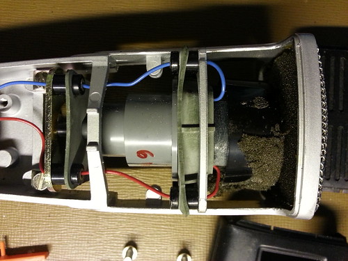

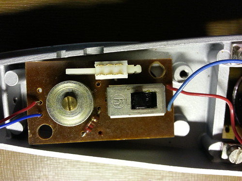

It has a big on-off switch on the front, and a bass roll-off switch down at the bottom. Supposedly up is for voice, and down is for music. Anyway, I got it in the mail the other day and I was all psyched. The thing has a Tuchel connector on it, so there was an adapter cable with it. Ok, no big deal. I expected that. Plug it in, nothing. No signal at all. Ok. Well, maybe it's the connector cable. Well, I grabbed a probe and got signal from each of the terminals, so I don't think it's that. I get some alligator clips and stuff and try to bypass the connector entirely right to the pins on my mixer. Still nothing. Ok, well then the cable is probably fine. I decided to have a look inside and see if something broke. I figured out how to get it open and apart (had to desolder the terminals at the bottom) and the plastic sleeve slides off. Inside, I see nothing much; the mic capsule itself, and a little PCB with nothing on it but what looks like a resistor, the on/off switch, bass roll-off slide switch, and this weird circular thing:
So I tried to bypass the board entirely and alligator clip just where the two wires come off the capsule. Still get nothing.
At this point I'm guessing to myself that the capsule is shot. But that would be odd for it to break in shipping, as well packed as it was. And it was supposedly tested beforehand. Now, like I said I can send it back and get another one that works. But because the mic has almost nothing inside it I'm baffled as to what could cause it to not pass any signal. I probed the PCB with my DMM and got signal passthrough at all points, and when I had it all back together again I plugged it in and when you flip the on/off switch, you can hear the click but again no signal.
Any ideas as to what the circular thing is on the board, and also if a capsule can just go bad? I'm more curious than anything else because I've never had a defective mic...
