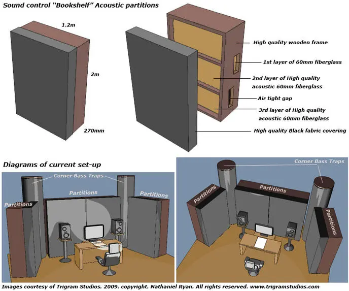

hi,, about two years ago i had four 1x2m bookshelves made to use as "mixing" partitions for my home studio,, they were built specifically for this purpose and therefore were made air"tight", we then packed them with rigid fiberglass and covered the cavities with fabric, placing them around the mixing poisition of my studio we created a nice "dead end" to the room for mixing,, check out the diagram for a better idea of what they are and how they work in the set-up : i recorded my demo in this studio and used it to get funding for a full length album thats in the making as we speak!
now the wife andi are of overseas to bigger and brighter musical projects and i need to find anew home for my partitions, if anyones interested in them give me a bell at trigramstudios@gmail.com cheeeers...
