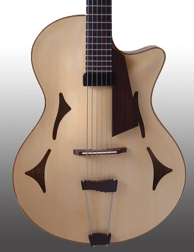

I used the maccaferri style cutaway on this one. It's not Macafferri and and it's not a tele and you will find similar I'm sure but that was my thought process.
Like I said though play with it until you have what you like. It's your idea and your outline.It is a lot cheaper to experiment on paper than with wood though.;)

My Gawd that's beautiful!
Yeh, to be honest I was very pleased with it but I have to be honest and say that a lot of the input came from the customer. He had the idea and we spent a good deal of time pouring over the fine detail of the curves and outline. My experience and eye with his vision came up with a winner. I don't always get that lucky.
To get back on topic though I always wanted to apply the same sort of cutaway to a tele and maybe a similar f hole on a thinline. Thats what made me mention it.
It sounds pretty good too.;)
