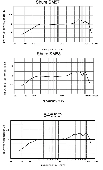

You might consider a used Shure 545SD if you can find one on eBay. That should be in your price range and it should be very close to an SM57 (but probably less tubby if my experience with the 565SD vs. SM58 is any indication).

I have a 545SD that I got picked up on ebay. It sounds like a 57/58 to me. Maybe brighter overall. Here's the plots for all three:
