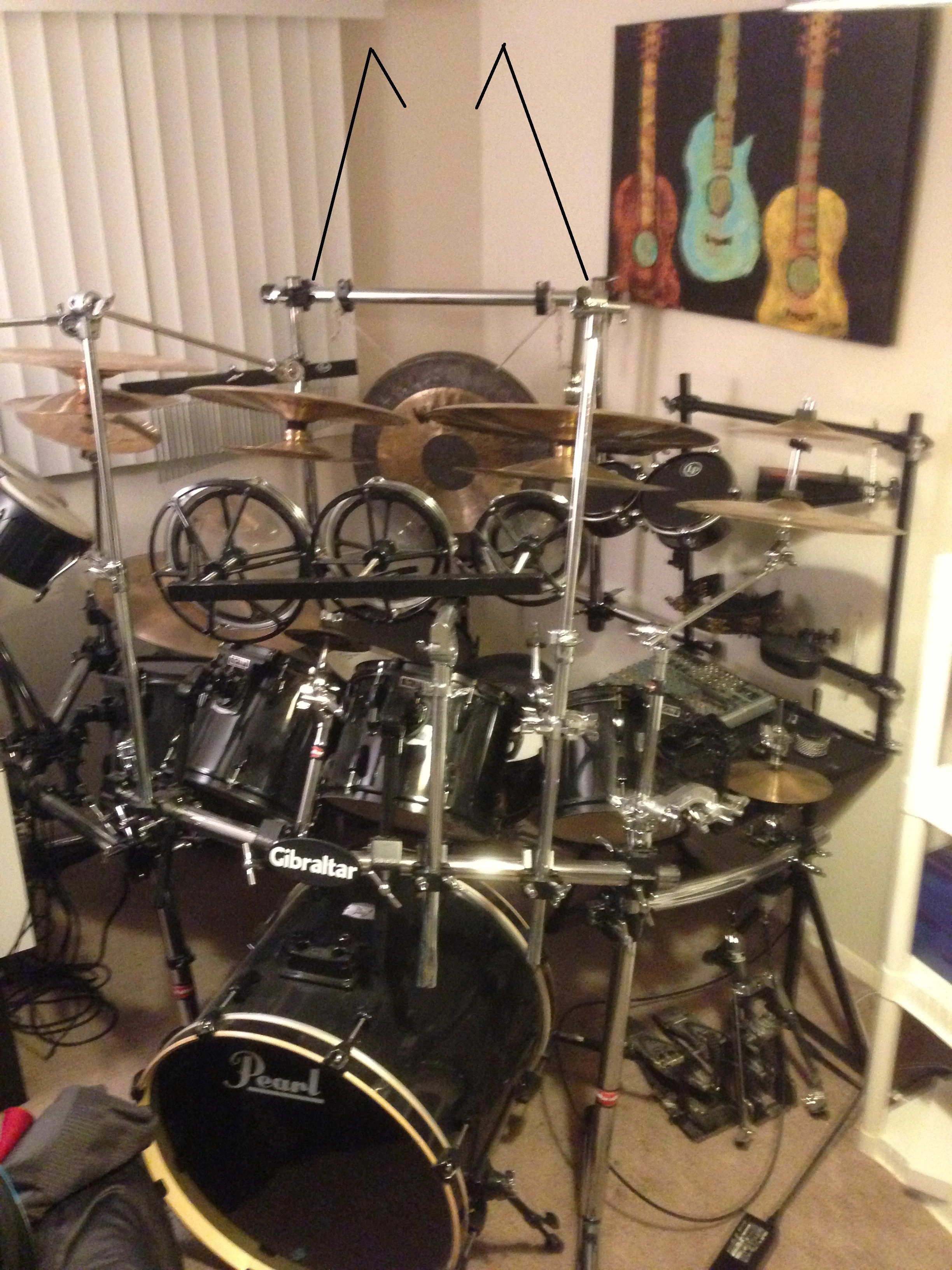

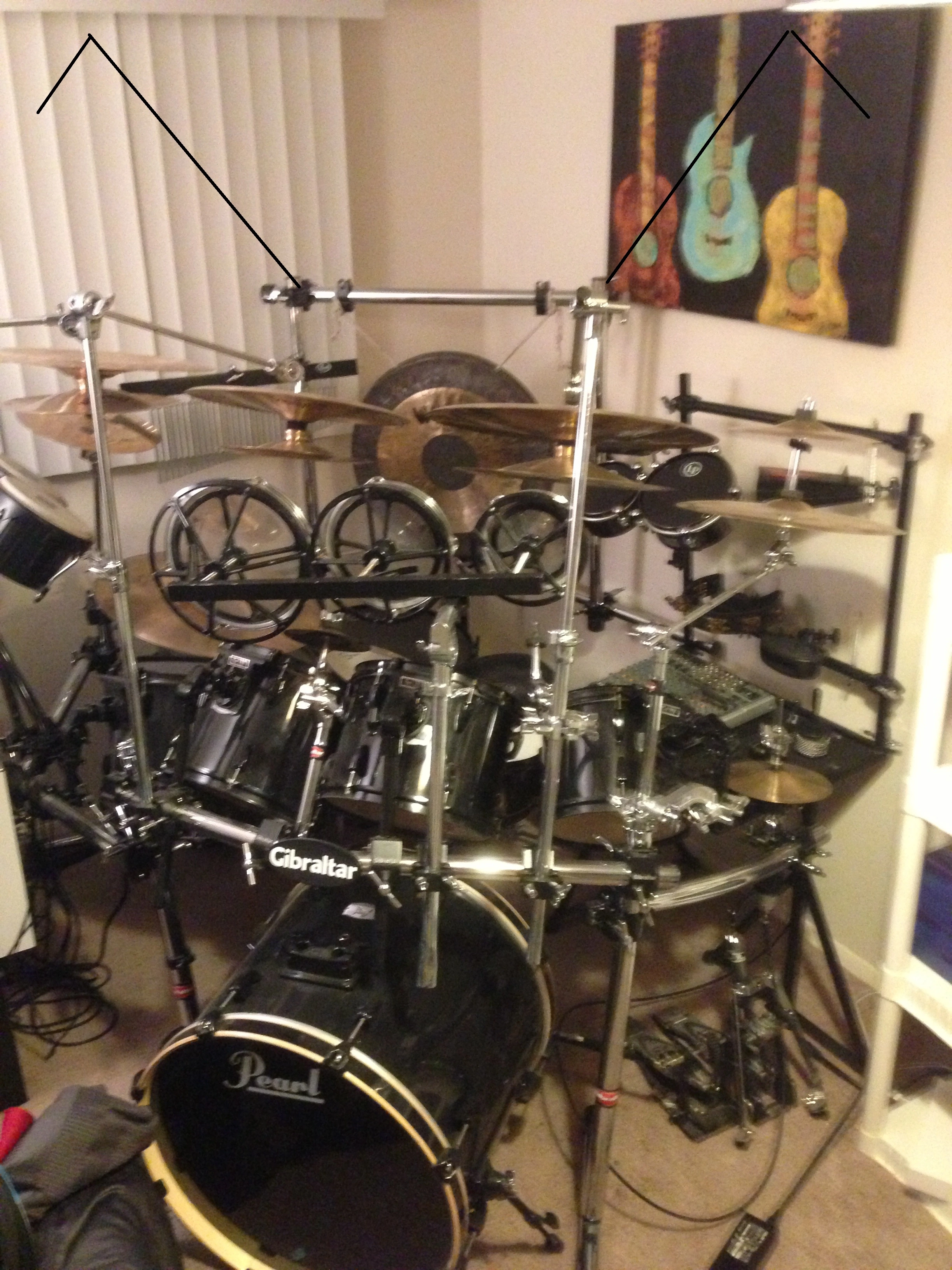

How should I mount the condensers i have seen people do it two ways so I mocked up drawing so you could see:
If neither one of these are right just let me know!

Like I said, your most important goal right now, is to get the kit sounding good. The room is going to try to kill you, and you are going to have to work hard to get it to work. If your drums sound bad, likely everything else will not work in a mix.
Overhead mics are the most important. At the very least, put some Auralex on the ceiling above the kit. Trust me, foam is not a popular thing to use in many other cases, but in a short ceiling height room like yours, it really helps the overheads to not wash out with reflections.

Yep, about 6 feet short of ideal. I have almost the same in my drum room, (9') but I have open joists that I filled with rockwool, so it works pretty well. Previous to treating that room, I had 8' drywall ceiling, that foam helped quite a bit.
And I would get separate mic stands for your over heads ... you will get noise transfer if you mount them to your rack.
Jimmy I think dude was talking about his bass drum, and you were thinking bass guitar. Could be wrong...
If you're doing the three mic thing you'll probably get better results putting the stereo pair out front. If it was me, I'd draw a line from the center of the snare through the kick beater and center an xy pair on that line maybe 2-3 feet out front. Set them initially at about the height of the rims of the rack Tom's angled down a little so they shoot at the snare. Adjust the left/right angle and/or move the mics to adjust the stereo image, and adjust the up/down angle and/or move it up or down to adjust the volume of the cymbals. At that point the mix is all you! Hi-hat too loud? Don't hit the damn thing so hard!
