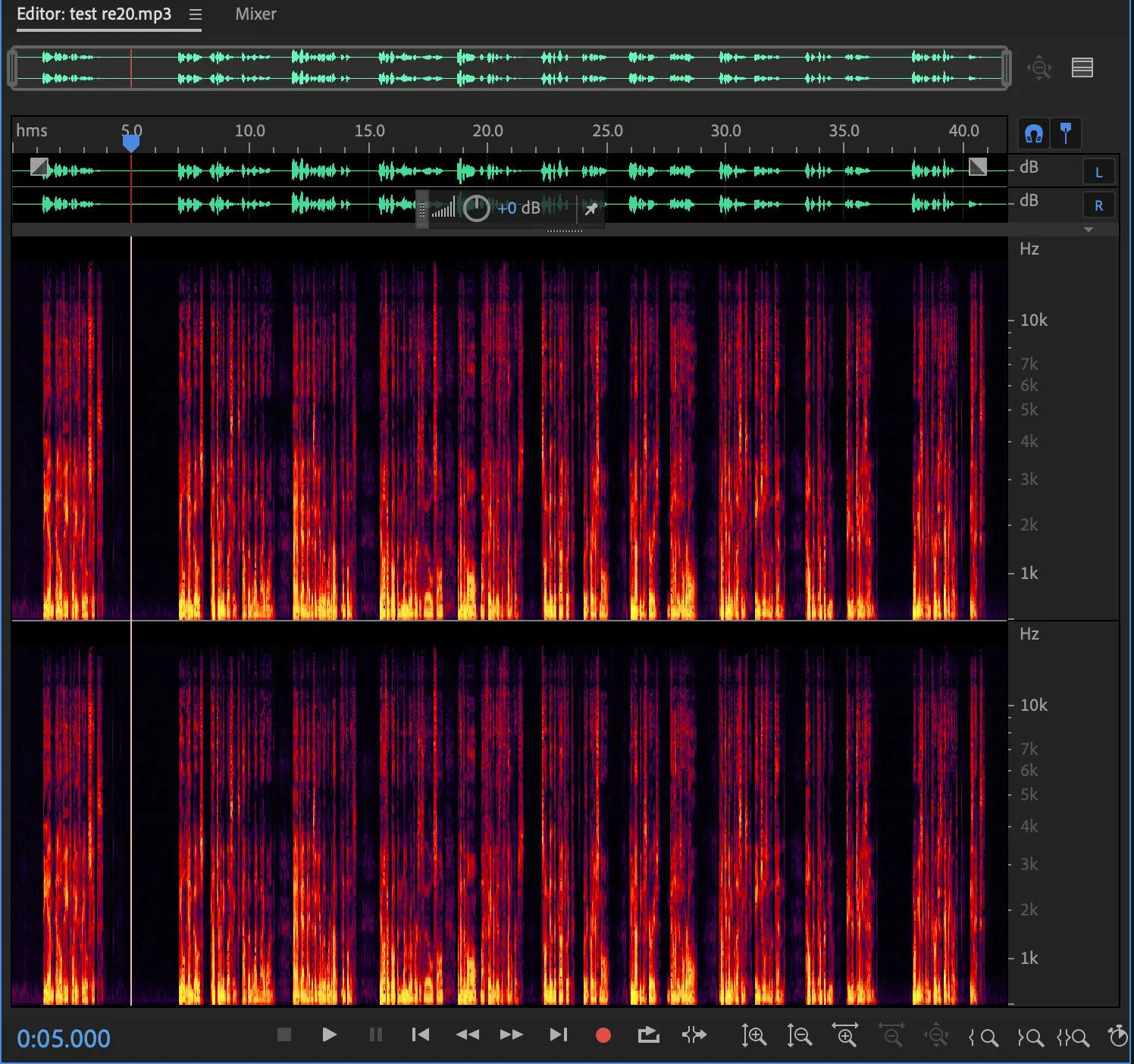

I've listened on speakers and on decent headphones and like the others, I think it's fine - but I have noticed something a little odd?
There is a very defined drop in energy between about 4K and just under 6K - I tried just sticking a bit of boost in that area and it perked up. It isn't like mic natural EQ, it's quite a defined cut?
I listen to lots of US audio books, and I'd have no issue with the tone of the voice, and your voice is clear and precise - I don't hear anything that concerns me.

i do appreciate the information...I am not quite sure how defined the Lewitt can be in the eq area..it is set pretty nice for the most part and I agree - a very little skosh could make a big difference but go the wrong way and oops. Any particular software equalizer you would recommend?

rob...thank you very much! I have a few narrations under my belt but those were just as analog was transitioning to all digital (dat tape etc) so your input is most welcome.
