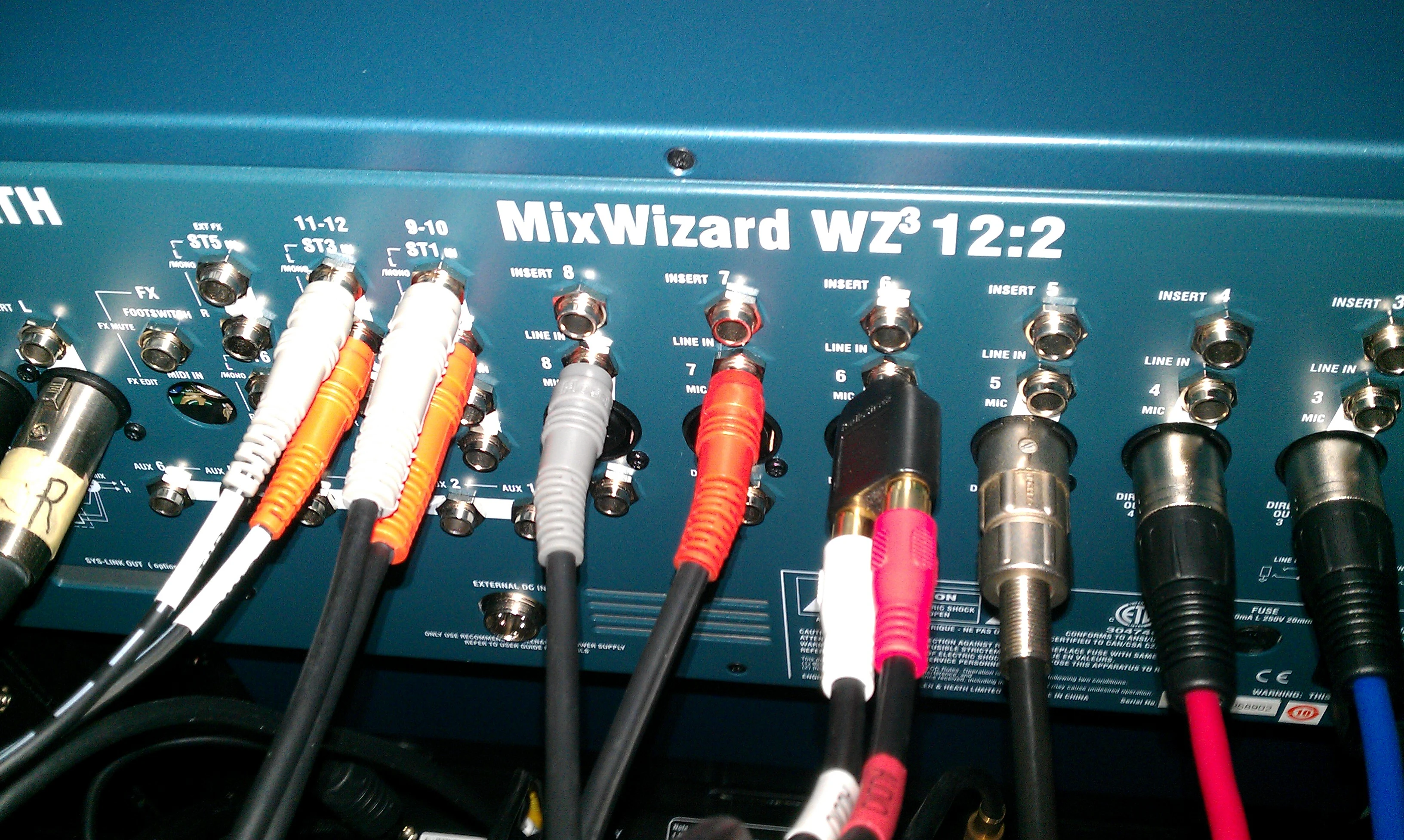

So I have some stupid news. It turns out that the church does not generally use their audio system for weddings . :facepalm:
BUT, all is not lost. Just take everything about what I said about plugging in to the church's audio system and apply it to the reception! :D
That's right. The reception hall has EXACTLY the type of audio system that I was expecting the church would have. Here are a few pix of the reception hall system:
______________

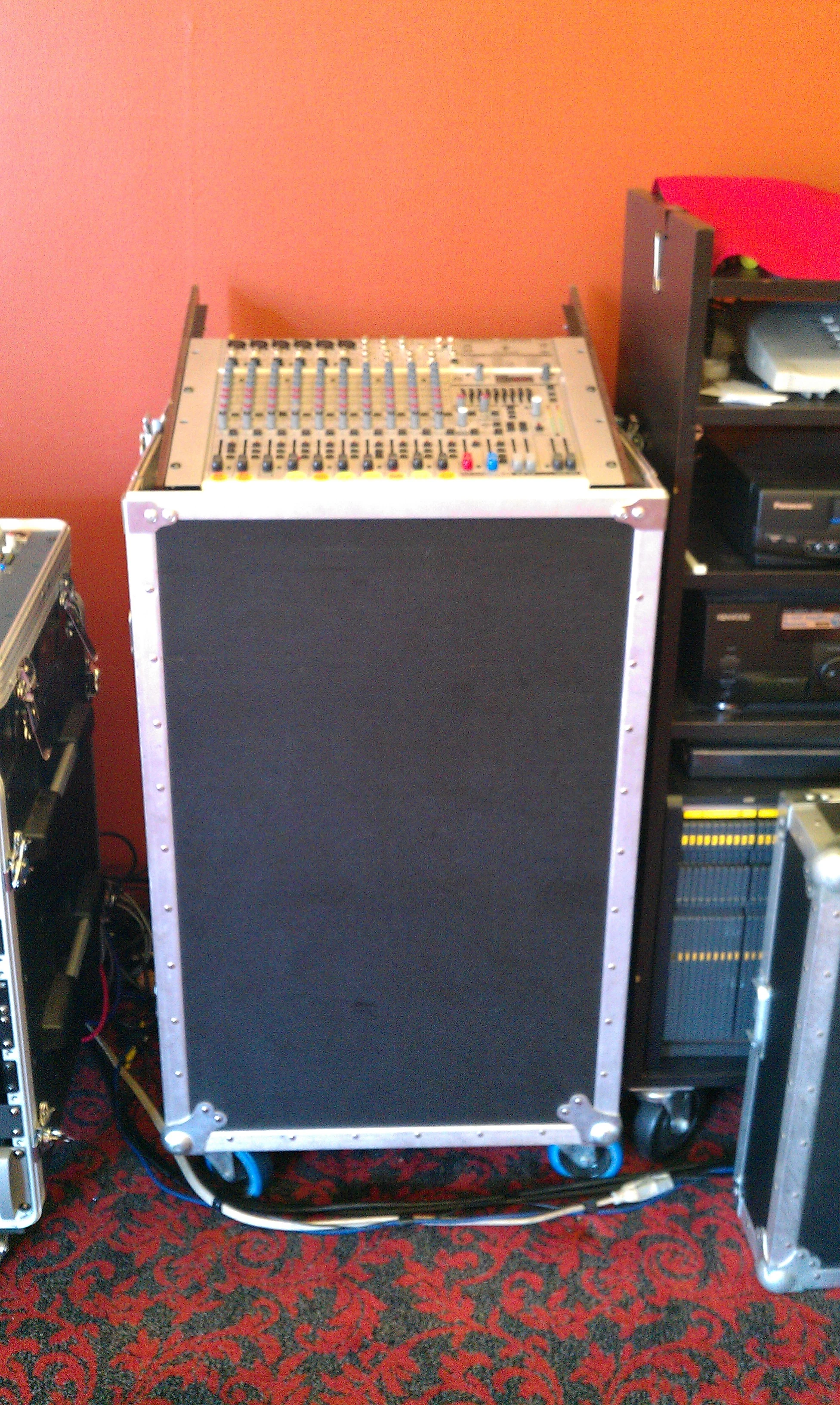

The primary setup rig with the main mixer on top:

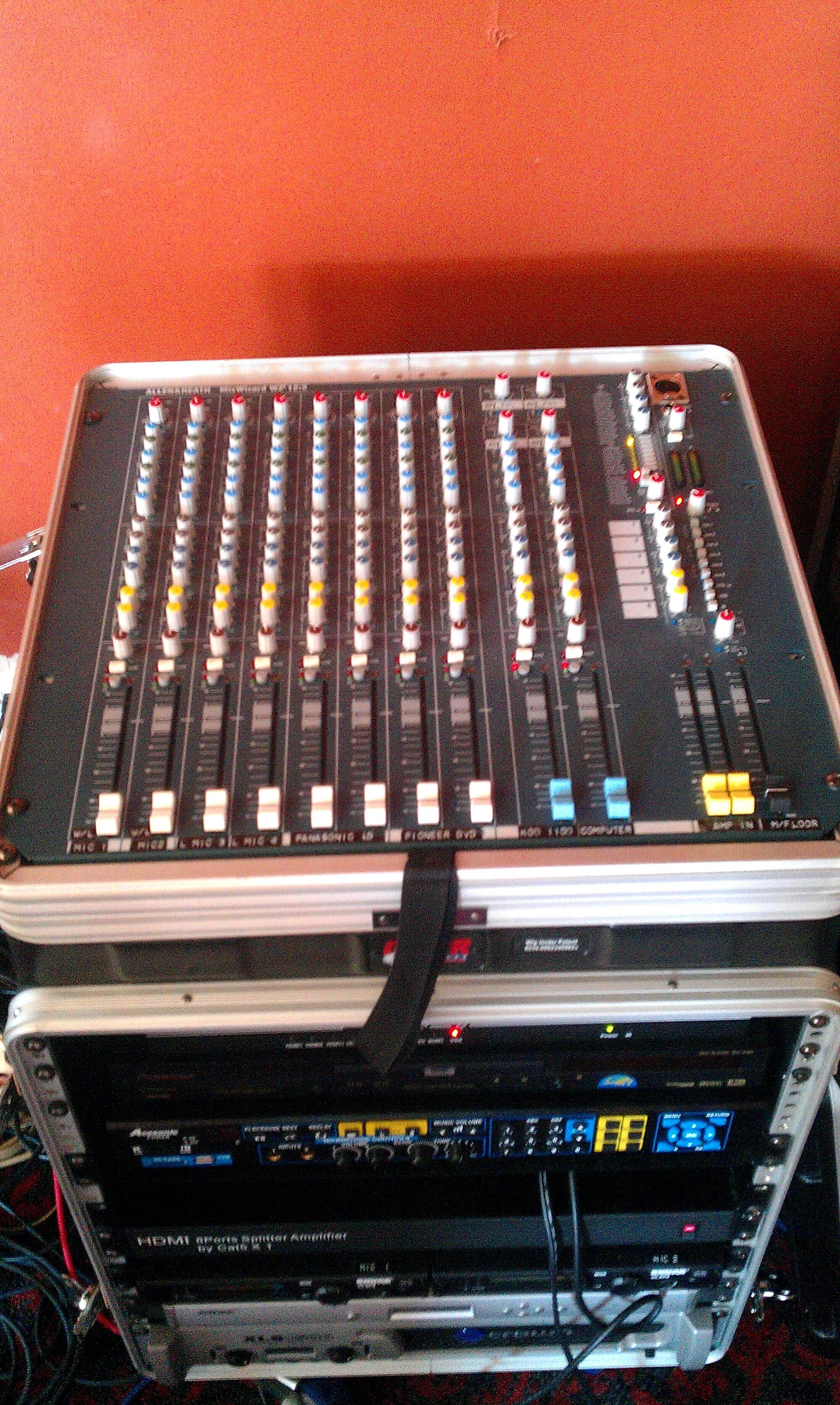

The main mixer (Allen & Heath AH-WZ3:12:2 Mix Wizard WZ³ 12:2):

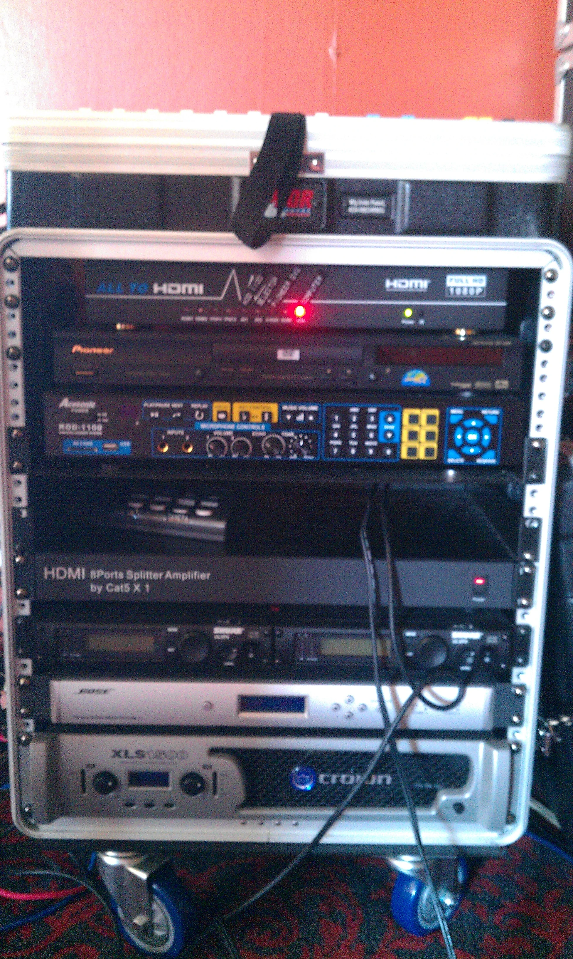

Under the main mixer:

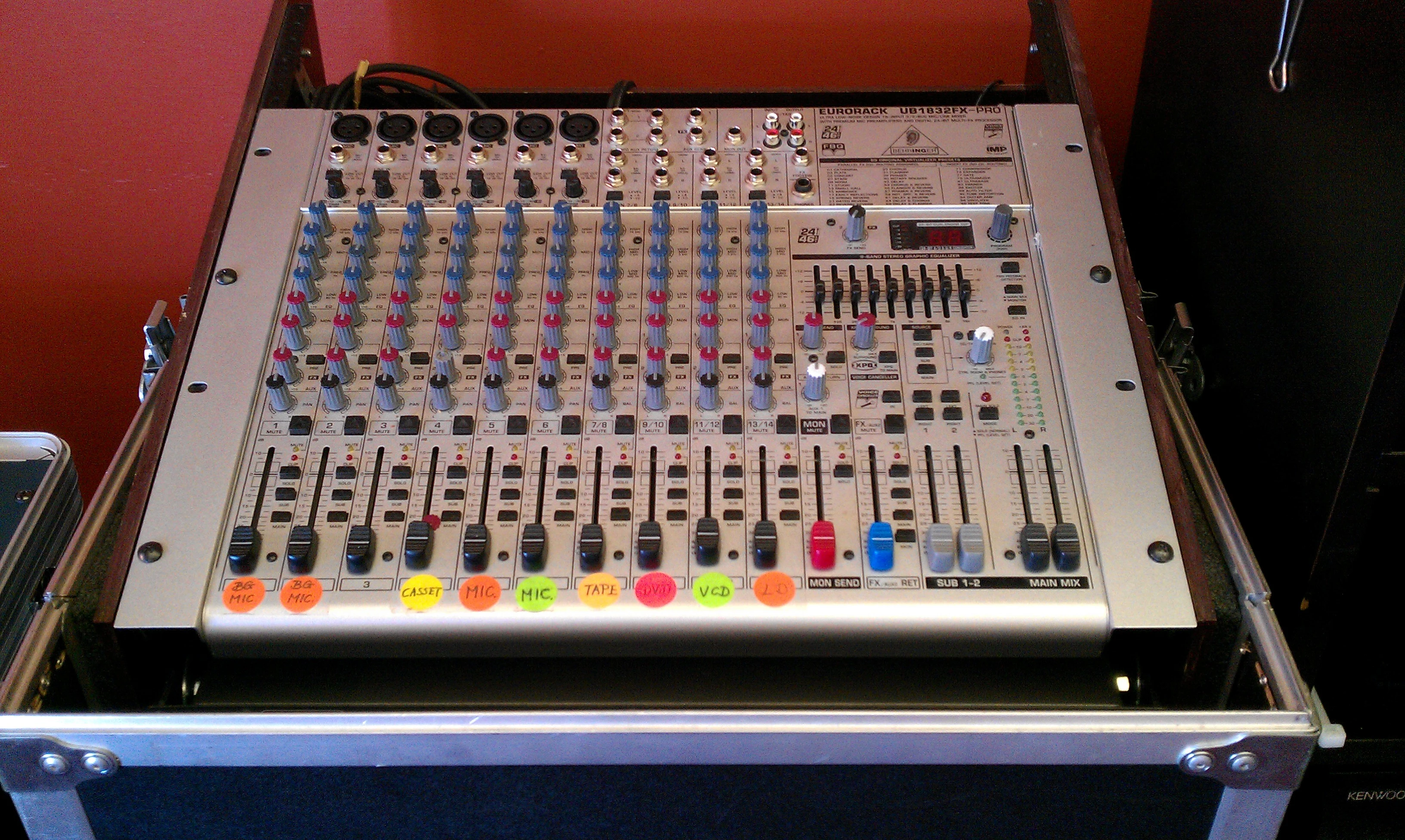

A second mixer ...for some purpose unknown to me (Behringer EURORACK UB1832FX-PRO):

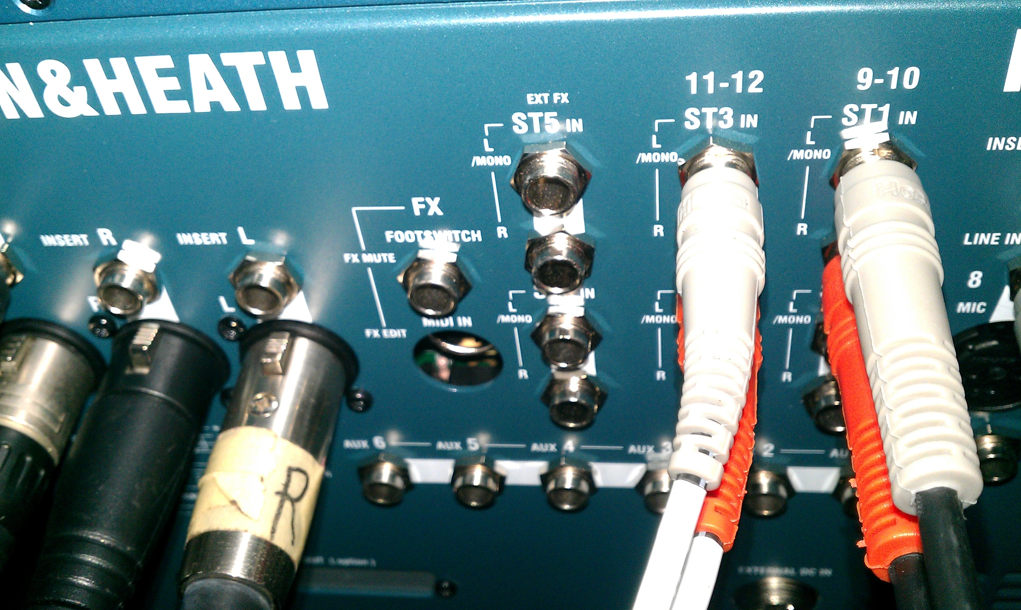

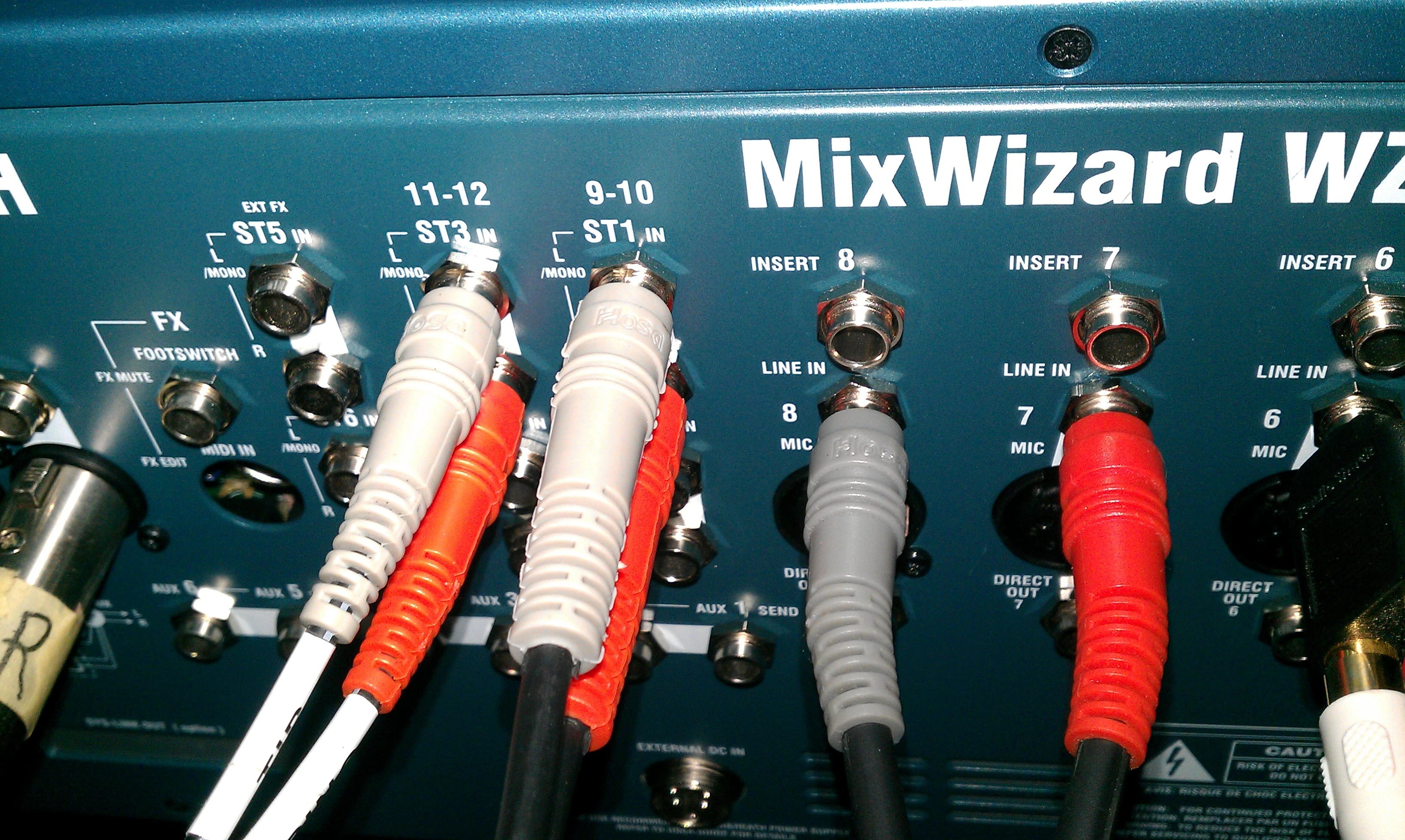

I tried my best to get pictures under the Allen & Heath WZ³ 12:2, but it was in an awkward location and those are the best pictures I managed to scrounge. As for the Eurorack, I couldn't photograph underneath.
At any rate, it does seem like they should have some kind of line level outputs, but maybe not. I'll look through the manuals, but maybe some of you already have experience with these types of units.
Remember, I'm planning on taking the main line level output from the necessary mixer and transporting the signal about 100 feet (~30.5 meters) away to an itsy Nady MM-242 set up on the balcony, which will further split the signal by sending it to a Behringer HA400 MicroAmp. Thanks for your help!
Now, for actually transporting the signal that 100 feet to the rear balcony.

Wow, I feel dumb. So I guess my 100-foot unbalanced stereo or mono run won't work with the Belden 8451 without some special wiring. :facepalm: Might have to heed the instructions in RaneNote 110 that bouldersoundguy linked earlier and make a good assembly or find a good balun. :D
__________________
EDIT 2:
Okay. I thought about it a bit, and I think I figured out why they have two mixers.
One is for all the mics and vocal inputs, and the other is for all the other device audio inputs. (They have a karaoke machine, a DVD player, HDMI connectivity, computer VGA/3.5mm connectivity, and more.)
From the setup, I assume the MixWizard is for the accessory device audio (DVD player, etc.), and the EURORACK is for vocal inputs from microphones and whatnot. (I can't say for sure, though. I'll have to go back and take a look at the wiring, but it's a good bet that I'm right.)
If this is the case, I might need line level output from BOTH devices and have TWO 100' cables going up to the balcony! (Oy vey.) Alternatively, I guess I could take only mono signals from each and ram both through the 100' cable. I'll have to think about that one. :D
__________________
EDIT 3:
Well, I feel dumb, again. The uses for each mixer are clearly labeled under the gain controls of the mixers themselves. :facepalm:
And it turns out that they use BOTH mixers for BOTH purposes (devices and mics). That certainly complexicates things...
Looks like I'll have to either be sure which mics they are using and keep them on the same mixer, or I will need to send two signals, one from each mixer, to the webcast control station on the balcony. This is to say of the mixers aren't connected to each other. I guess I'll have to go there again and take a closer look. :)
