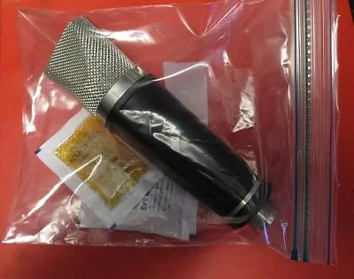

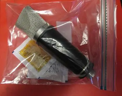

Or could be dampness on the mic capsule from humidity in the air or from ones breath as they speak closely.
I've had two mics that were susceptible to dampness that I've dried out using desiccant packs in a ziplock bag with the mic for a couple days. One mic (a CAD M179) barely had any output and was noisy with crackles and static). The bias voltage on the capsule diaphragm doesn't like moisture.
