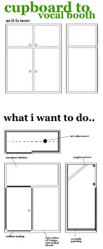

Plan so far..
If you could tell me what you think of my plan so far, improvements ect? I would be very grateful..

It is definitely doable. What are the inside dimensions? For a closet probably the best thing you can do for acoustics is to make it as dead as possible. Try to find a source of rigid fiberglass if possible and line as much of the walls with it as you can. This will minimize the effect of the small room on what the mic picks up and will allow you to do your processing of the vocals later on.
Darryl.....
Thanks man, i think its 8ft tall... about a ft deep... and about 4 ft wide... i tried recording in there with some padded stuff and it worked kinda ish... but it did sound like i was in a small room... so fiberglass will do the trick? no carpeting/foam or anything? What about angles, should i leave it square.. or maybe angle around the mic area?
I'm not so sure if the angled mirror is a good idea. You mean the vocalist can look to the ceiling and see the control room? It would be upside down, wouldn't it? :eek: If you look through the window into the boot all you'd see were the hair of the vocalists, right? :rolleyes:
Why don't you just cut a whole into the second door and put a piece of glass in it? Should be much easier and the vocalists can look outside since he/she stands right behind that door.
In any case, this should be an easy project. Good luck! :D
The mirror was actually going to be put there mainly for light... i kinda figured it would be the quietest way of getting light into the booth.... also.. i think it will look nice :p But... what kind of padding/material shall i use to make sure no sounds get in?
Also, i dont think they would see them upside down... it would just be a view onto the control room...
