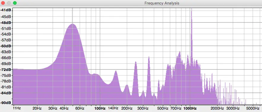

This is the spectrum of just the noise component, i.e., after bass tones are silent (from audacity):

The noise is low-level. It's a high-pitched tone, possibly stemming from a PC or a fan or something like that.
Does it become more or less if you move the bass around in the room? You can find the source that way (if it's electromagnetic(EM) interference). I believe chances are high that it's EM radiation on the pickup as the noise disappears when turning down the volume on the bass.
I think it won't be noticeable in a mix, the sound of bit-crushing or sample rate 'aliasing' while notes are sounding might be a bigger issue :)
Also if you still want to remove the noise from a recording , a narrow EQ notch can help as it sounds like a stable sine wave on a specific frequency.

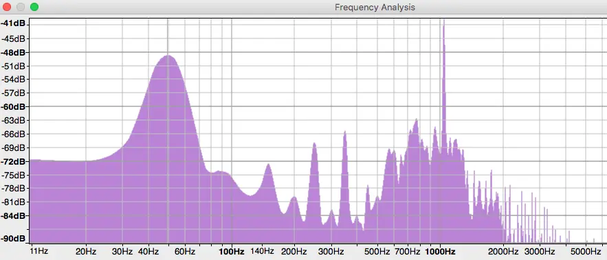

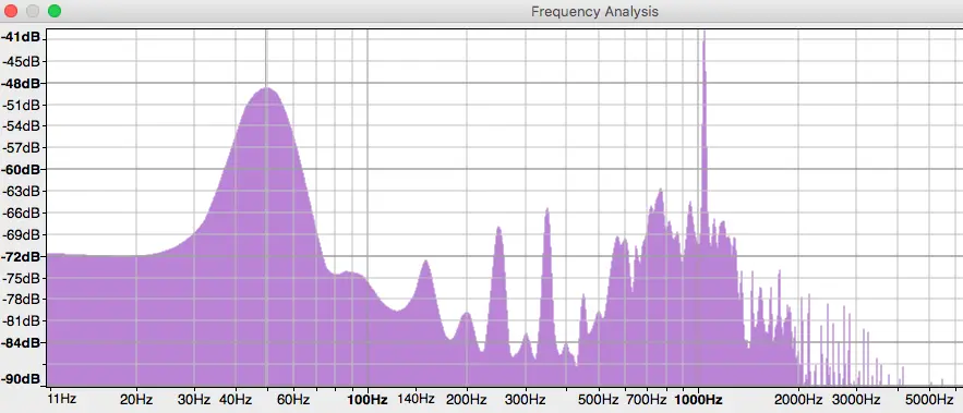

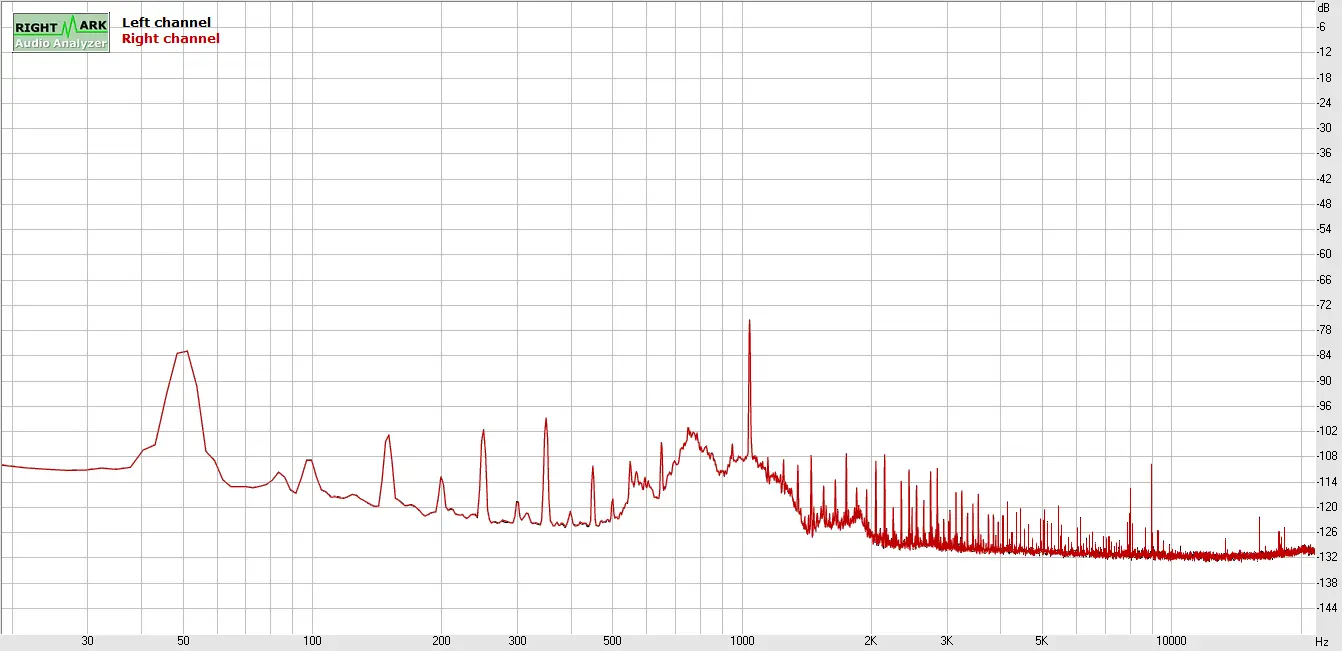

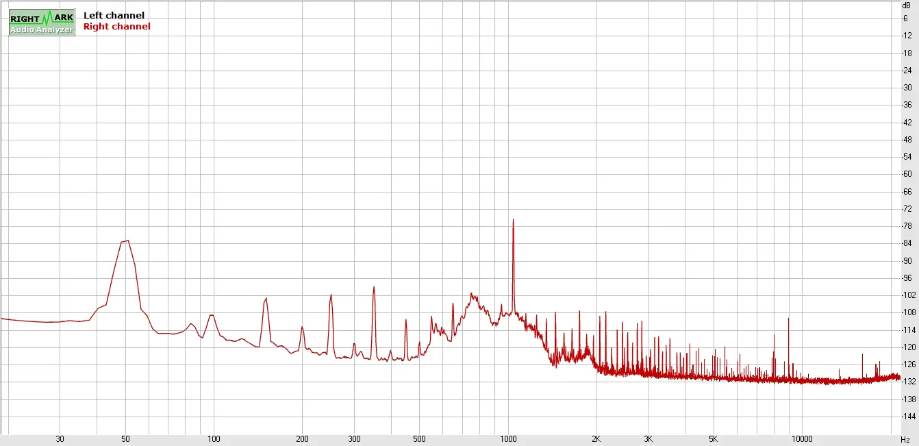

Rightmark Analyser give a clear picture of the noise, just a sniff above 1kHz.
The 50Hz hum is quite evident, this is after the playing and I presume the bass had been "parked".
No idea what it is I am afraid. Looks for all the world like a cheap, 16 bit converter running Windows. Not of course.

like ecc83 graph, that tone about 1khz is like some tone generator, 1khz... pretty loud.

Yup dude, exactly Tone Generator likes! ?
