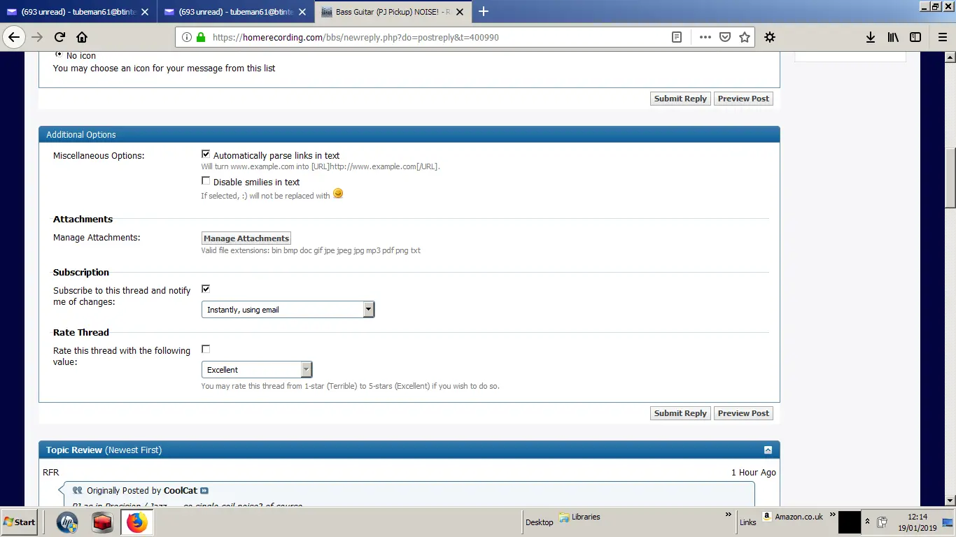

Scroll down in Advanced untill you see what is in "attachy"
Click that>find files>browse(I usually put what I want to attch' on the Desktop and name it)>open>upload>done>

So sad and strange! There is no ATTACH FILE option provided after jumped in to advance option! Btw, android chrome browser is in action.

Can't attach due to no file attachment option! ?
