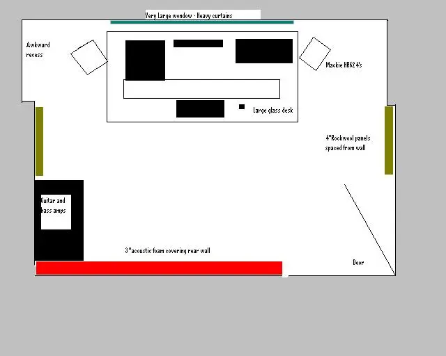

I have 2 x 4" thick rockwool panels free standing in the lower corners at the front of my 'studio'. I want to put more at this end (the rear is being sorted soon).
Now, should the next 2 be over the top corners (covering wall to wall to ceiling) or behind the monitors (in the middle of the wall covering wall to wall only)???
I'm concerned about rear bass problems bouncing back into the room from the Mackie HR624's.
Help??? :confused:

Could you provide a sketch of your layout.
Speakers - including ported speakers - can cause cancellation problems in low frequencies - so the closer they are to the wall - the more important the trapping becomes.
Are you doing any actual testing - or is this all just by ear?
Rod
Sadly this is just by ear at the moment.
Due to the placement of the large window and the VERY thin rear wall the studio is set up length ways (don't give me too much stick... I wanted it the other way round but it would have proved very appealing a space to be in.
The overall size is about 7'x9'x9' - Nice and high but still a small space :rolleyes:
