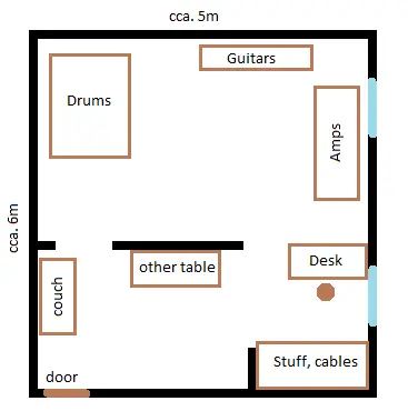

Capt Hair said:And something to cover the window, there's going to be some weird reflections coming off that wall.
And I would move the couch over to the right so it's sitting in that corner to help stop some of the weird bounces that may happen.
You shouldn't do anything about high frequencies until you sort out the low frequencies. 1 in each corner is a good place to start it seems. You'll also probably want one above where you sit and on the back and front walls and the side walls and the corners between each wall and the ceiling. =P
That quote should be a sticky on every forum on room treatment. Hell any forum on anything involving recording!
.....and just like with posting links, everyone should need 10 posts before they're allowed to type the word "foam". Hopefully, by that time, they'll have read enough to know not to type it.![]()

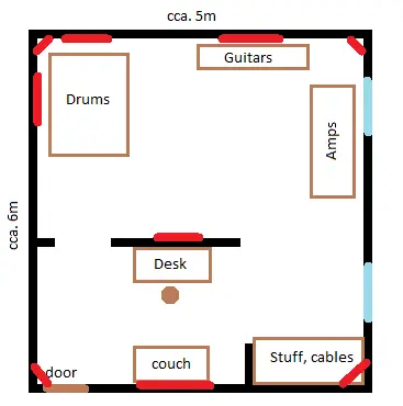

Ok, thanks. Mixing at the "other table" was my first idea, but I chose the desk near the wall, so that I can see for example the drummer, while I'm tracking drums. But after watching few episodes of studio rescue, I will move the desk to the center and make the basic first reflection thing
Do you think, that this will be ok?
