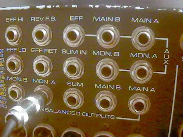

I didn't think of muting the playback for the Line/Mic2 in the windows control panel. I figured this would mute what is coming into that and not record it.. I guess as long as the recording option is set at the Line/Mic2(which btw is a 1/4' input that panned all the way to the left clicks and it acts as Line In, and to the right past the click acts as a Mic input with the gain control). I have been using that input on the Mic feature not Line coming from a Peavy 1601 stereo 16track using the "Mon. A" output(the board says that those outputs are "unbalanced btw.".. I have those outputs on mixer as well as "Main A and B" and another set of "Mon A and B" on the AUX buss I guess.. Can take a digital pic qucik if anyone so desired.. But anyhow, to recap, running that "Unbalanced Mon A" output into the front of my soundcard on the Line/Mic2 jack using the Mic side with the gain about half... you saying I should switch it over to a Line input? From my experiece, that really quiets that input so not a whole lotta signal comes through.. I'll try the muting thing now.. And i would experiment with the outputs on the Mixer into my sc but I'm afraid of voltage mismatches and whatnot(where's that thread again..) Oh, btw, the metronome in Sonar is MIDI so unless I mute that as well, it should be heard.. Here we go again!! Wheeeeeeee! Thanks for your help guys! This is fun! What I would be doing without this board...

Pic is attached..

ok I forgot that you have the sblive with the live drive in the front. Thats a whole different story. The reason I suggested to use the line input is because you mixer should be sending a line signal, and usually you wouldn't want to add another mic pre in the chain (especially an sbllive one) Can you post a picture of the mixer itselff with faders and such? The signal should come out just fine using the line imput. If you go into that recording control panel you can turn it up in there and you'll get more volume that way..

Yeah, I'll take a pic of the mixer tonight.. i tried switching the live drive input to Line and it worked fine although it only sent to one side of the headphones, when its on the Mic side, you hear it through both cans.. Coming out of the mixer, we only have one line so I'd assume exerything we are recording is technically mono. however, when the tracks are recorded and played back, the signal is coming from both speakers.. And if i Do mute the Playback level for the Line/Mic2 in, it dosen't come through(MIDI Click track still does :) ) I think yesterday we did a pretty good job. The guitarist ended up laying down his rhythm track to a click. Then drummer to that, vocals then bass.. We all kept time pretty well, there are a couple spots that sound a little sloppy.. It's a very fast song(187 tempo).. At least we have a few tracks that Almost fit together.. Everyone will take a few more takes and see if we can get it perfect.. Anyway to record at a slower tempo and speed it up? I saw the time stretch plugin.. I guess that would work. i'll post a pic of the top of the mixer when I get home from work.. Tanks guys..
