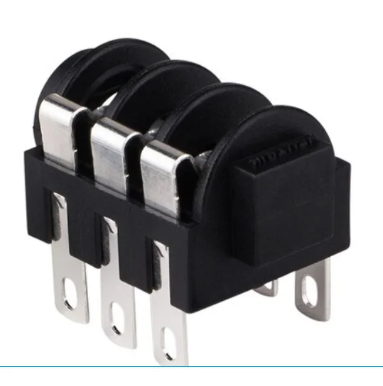

I have one of these insert jacks that went bad.
If there is no cable plugged in the preamp channel has no sound- dead.
If I plug in a Insert cable the Preamp Channel works.
Assuming its some spring/tab has lost its contact ability but I don't know for sure. Seems it might be like this drawing?
Anyone know where to get the part or the correct description of the type- jack?
Seems most plugs are open until somethings plugged in, where a Line Insert is "closed" until a cable is plugged in.

You might check Parts Express. The problem will be finding the exact part. Maybe something like this..

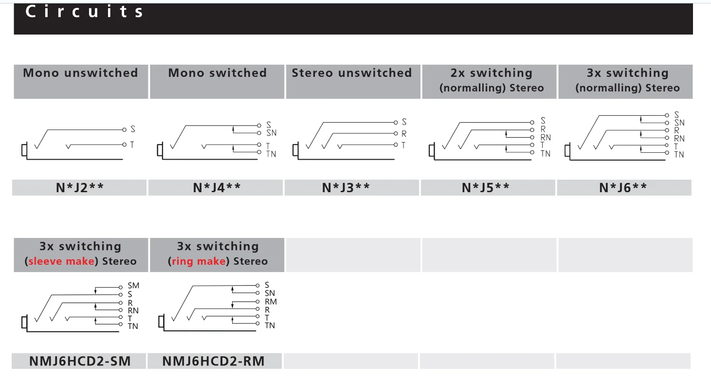

CC, you might see if you can find a part number before ordering. I found this showing how the switching works for the various different Neutrik jacks. You'll want to get the right one!!!

im going to assume its a standard Insert Jack used on many mic preamps and consoles.

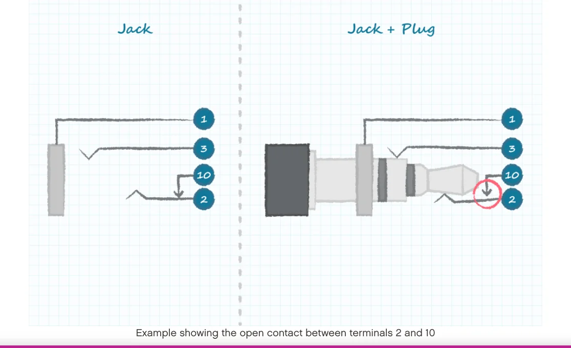

When the plug is inserted all these little contact arms lift up. So Im assuming the removal of the plugs, allows the contact-arm to set down and make contact.
So its looking like the Neutrik choices J6 style is "normally closed" and inserting the plugs/cable opens three contacts.

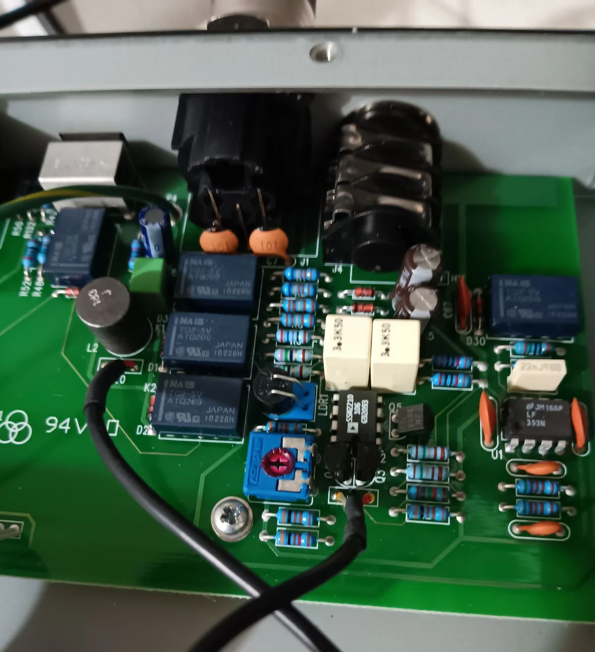

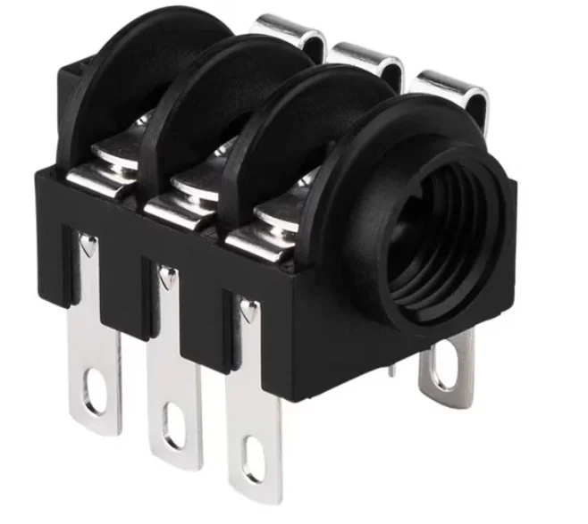

This picture looks like the one in this unit. The left side pins, are stationary "bump" contacts. The arms lift up when a plugs is inserted. So Im guessing, and it was visible when I pulled the cable plugs out, healthy contact-arms closed quickly with a snap, while this problem Tip Arm had a weak, lazy, return. I'm kind of confused on the drawings that show other points, when all I can see is just the three contacts. Are there another set of contacts inside the plastic housing? Seems like J6 ...and the RM(ring stereo) J6 choice.
Maybe a J5?

My guess would be the J5. With no plug, your send and returns are connected. Insert the jack and the send and receives are lifted and connect through the ring and tip of the jack which come from your device. The sleeve is, of course, the ground and doesn't need to do anything.
