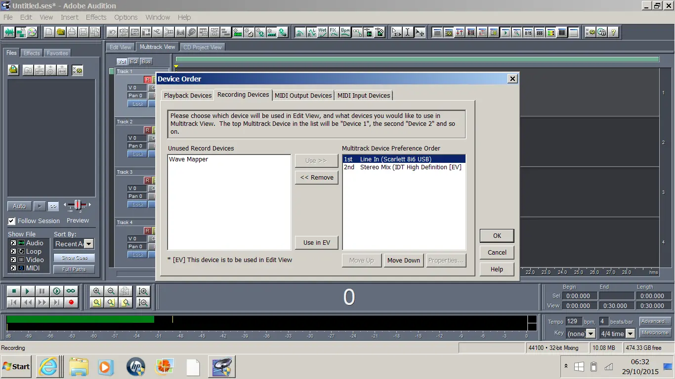

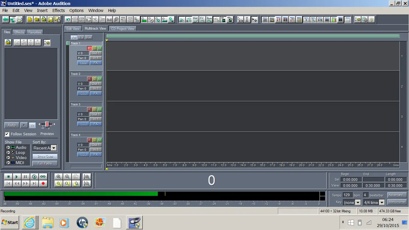

Plugged it all up again at 06:00 today and lo! The meter works in rec' pause.
I have had to re-install the complete package of driver and MixControl but I have not as yet launched MC so this is working with the default setting in Audition and the 8i6.
This is how the 8i6 shows up.
