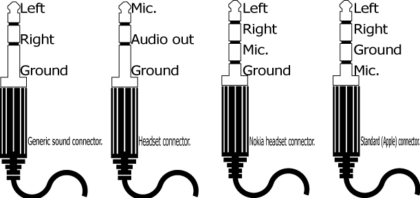

I think you still might be having an issue with the cabling. It's not just a stereo output. The spec on the Gigabyte G5 is 1 x 2-in-1 Audio Jack (Headphone / Microphone), That means it most likely a 4 point plug, and these 3.5mm jacks are NOT standardized! An Apple connector is not the same as the Nokia connector. I have no clue what your Gigabyte uses.

Thanks TalismanRich, I didn't know it's a 2-in-1 jack, however, normal headset without mic and with the same jack seem to work, do you think this could still be the problem?

There really should not be an issue feeding the 404 from a STANDARD TRS laptop HP jack using a 3.5mm stereo to 2X mono jack. There might be however if the laptop jack is a 4 pole type. "Impedance" here is a red herring, don't worry about it.

It could be that your interface input gain is too high, or the output level from your laptop is too high, or, as others have said, it could be pole shenanigans with the 3.5mm output, or just that the cable/adapter you're using isn't suitable.
Since headphones work fine from your laptop we can assume there's left + right audio on the tip and ring.
If it's a stereo track you're dealing with you will need the 3.5mm to two 1/4" plugs, which would go to inputs 1+2 on your interface.
The 1/4" plugs should be mono/unbalanced (one tip, and one large sleeve).
If possible, check that it's wired as follows with a multimeter.
3.5mm tip to 1/4" (1) tip
3.5mm ring to 1/4" (2) tip
3.5mm sleeve to 1/4" (1 and 2) sleeve.
