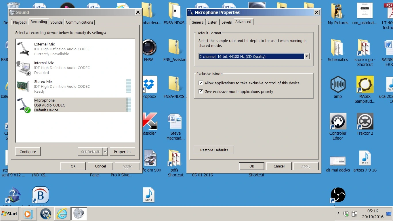

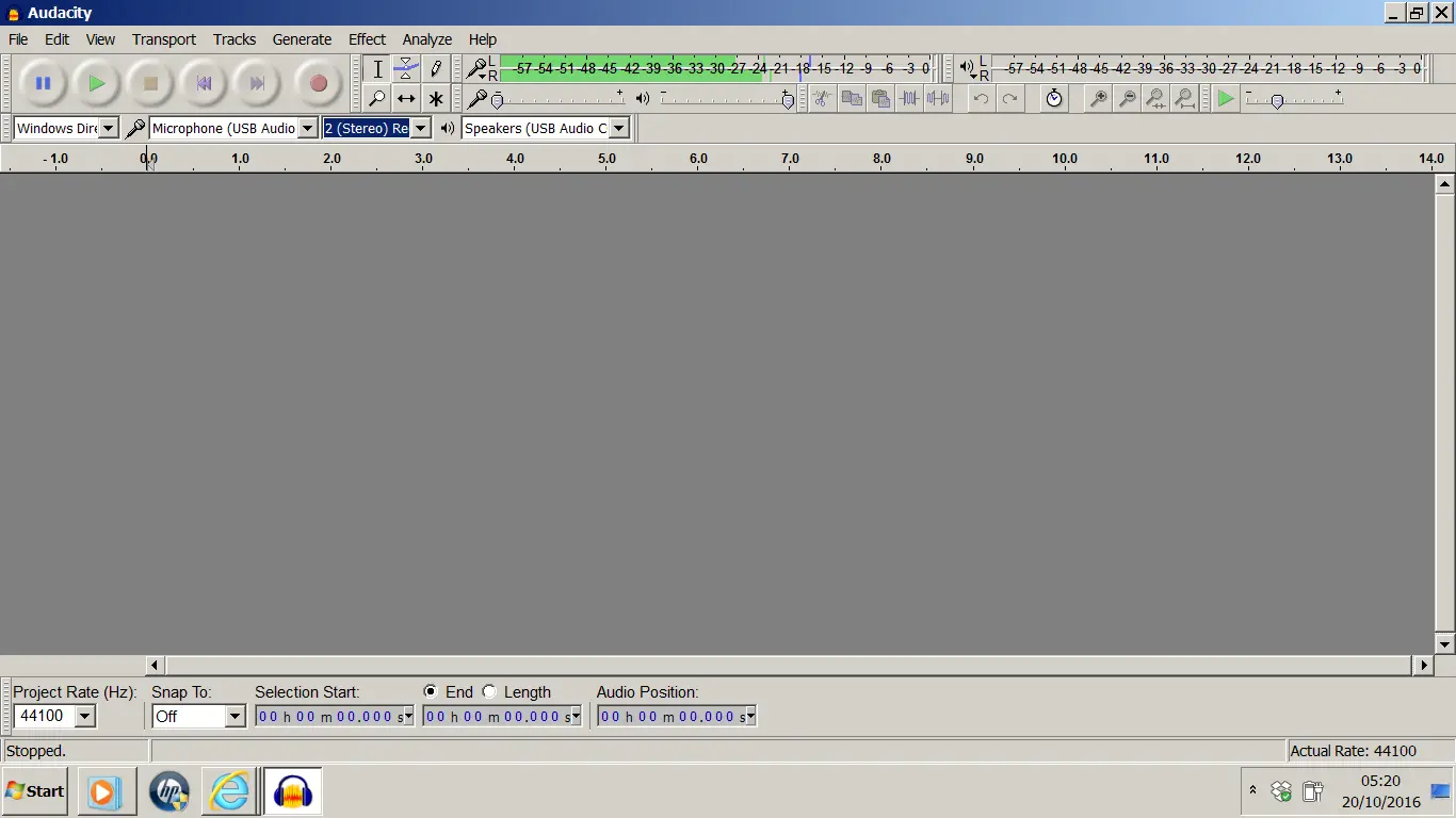

So, Audacity but then I learned something about the UCA 202. It can be setup for various input configurations (in Win7 at least) Attached is a screenshot of how to get it set for stereo 16 bit CD quality.
The signal source was the SCART* audio out of my FSTV playing Radio 3. The 202 level (in Win) was set at 3. This gives an average modulation at -20/24dBFS, bit low but "4" pushes very close to -3 on peaks and that is way too hot. Flipping over to R2 even on 3 it slams the meters. Never quite over but bloody close.
*Level specc' is a bare "0.5V". Don't know if that is an operating level or max op? In any case the 202 was quite happy with the feed, headphone sound was punchy but very clean,in fact I have rarely tried cans on my 202, quite impressed! Senny HD 448s.
