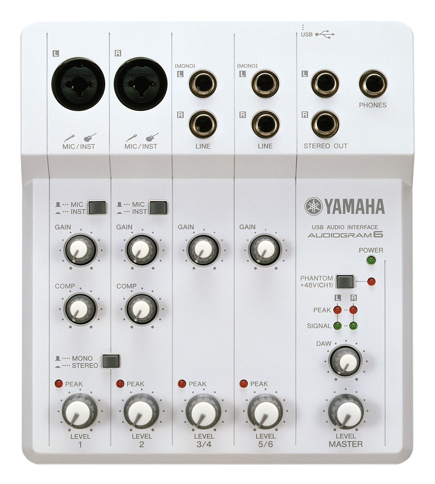

I have been very close to buying the Yamaha Audiogram 6 but I have decided to be patient and wait for advice. I have read as many forum threads and review on it as I can find with the usual mix of positive and negative comments. I was attracted to it because it is Yamaha and it seems fairly simple but it is only USB 1.1 which is odd for such a new audio interface and I have read about other issues e.g. with the drivers etc.

Strangedogs - Have you had a look at the Yamaha Audiogram? My attraction to it is how simple it appears to be. This is USB 1.1 like your Boss. Here is a picture of the interface - http://www.woodbrass.com/images/woodbrass/YAMAHA+AUDIOGRAM+6.JPG
The audiogram has a jack for phones, so I'm assuming (hoping) that this means there is zero latency monitoring. There is also L and R input on one channel which would be ideal for my digital piano, and it offers compression on the two mic channels. Anyone have any thoughts on this?
