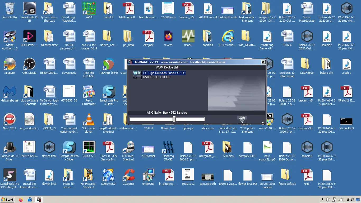

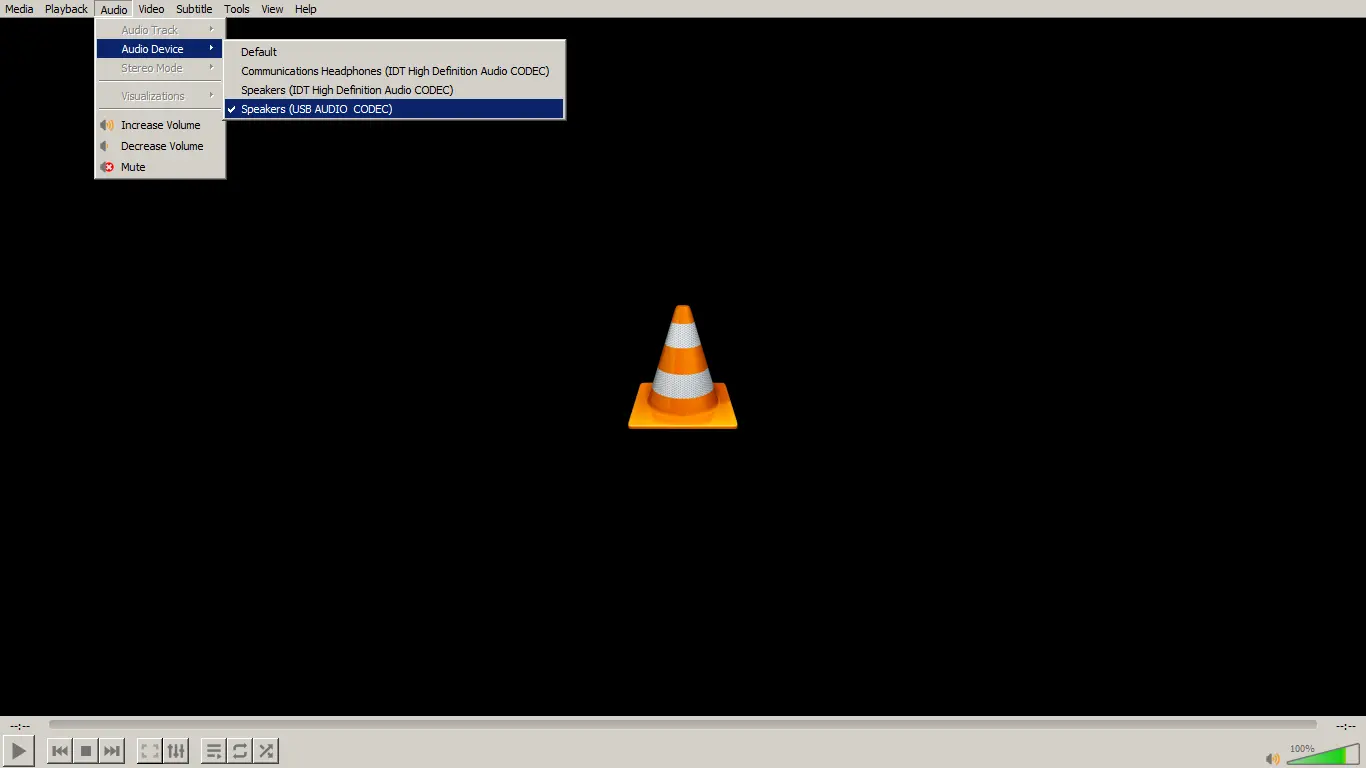

After making sure the 202 is the default playback device for windows you need the settings to show much as attached I think.
There are more settings in both VLC and ASIO4ALL and you probably need to go through them to get this aright.
ALWAYS with audio there is a need to get ALL your little ducks in row or they don't play nicely!
