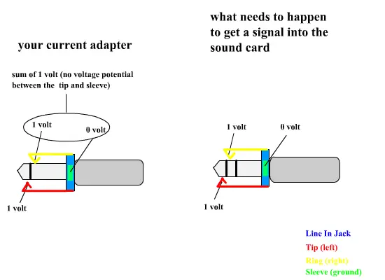

LinkTGF, that's exactly what we I needed to know. I have owned the 990 and the audio buddy and I can tell you that the 41 volt phantom power of the audio buddy is'nt your problem.
I think I know what the problem is. The short answer is: you need a y cable, 1/8" male plug to 2 1/4" male plugs.
The long answer is: the line in jack on your sound card is a stereo input = left and right = 2 mono inputs via a single jack. The line in jack is a 1/8" trs (tip, ring, sleeve) jack. You are connecting the mono output of your audio buddy to the stereo input of your sound card. Let's say theoretically that your audio buddy is putting out a 1 volt signal on the tip of your mono 1/4" cable, in reference to a 0 volt ground on the sleeve. In order for a signal to travel thru your sound card, there has to be a voltage potential between the ground sleeve and the signal tip of the cable. A 0 volt ground and 1 volt signal = 1 volt potential. If you ground was 1 volt and signal was 1 volt, there would be no potential = no signal going thru the sound card.
Ok, with all the wordy crap out of the way, what I think is happening is your mono 1/4" to 1/8" adapter is removing the required voltage potential between the signal and ground. See the diagram below to understand what I'm ramblin' on about (i think i have Fitzpatrickitis). :D
Then again, I could be completely wrong. :confused: :D
