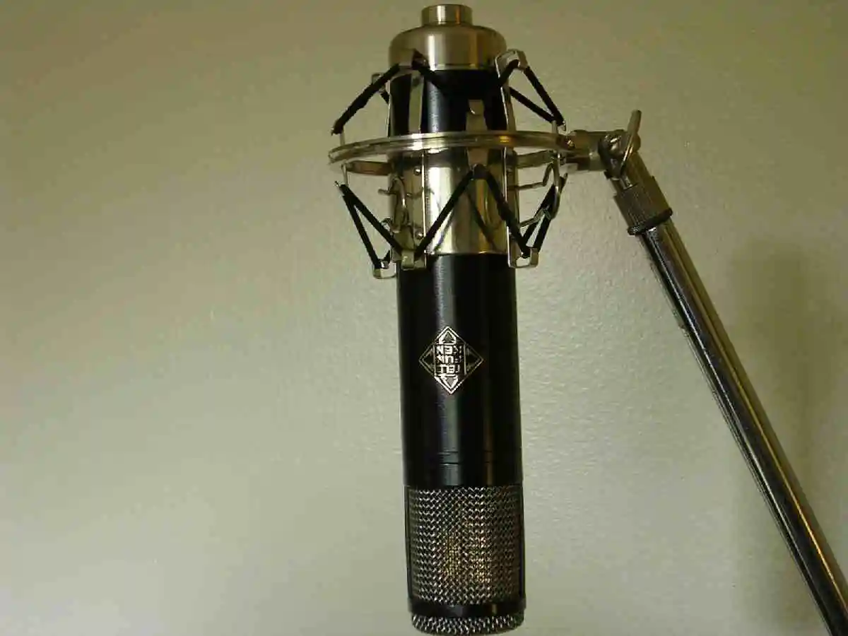

PhilGood, I'm doing the electronic mods before I do the Capsule....saving it for last. I'm going to put in a CEK-367..... I'm not looking for a flat sound. Trying to make it good for Voice Overs.
While testing the mic in various stages of mods, (I test after every mod, just to make sure I'm getting it right) I have noticed this dynamic thing going on... sort of a bit of compression. I'm always comparing it to our Schoeps with cardiod capsule, as that is the best and flatest we've got. Apex right now is more usable for VO than AKG414, as that sounds too flat for voice, right in the mids. Anyway, I notice a difference in dynamics while testing side by side with these other two condenser mics. The transformer change has taken care of some of it, and I'm thinking Marik suggestions a few pages back may be a further improvement. OR.... maybe it's just a tube mic, that has it's own dynamics. I'm going to try and attach a pic of what I've got so far.
  • Apex:Telefunken.webp
