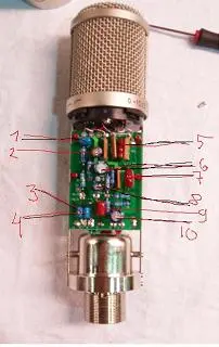

Just a fun question. I've been looking at the schamatic and wondered what a 1km resistor (R10) is doing hanging off the capsule's ground?
Also What would happen if I lowered the value or complietly removed (C2).
Marik, (Mark)
I've been looking back on this question and think it's a good one. Is R10 (1G) doing the biasing for the grid, or is R6 (200M)? My guess would be R6. In the C24 mod did you change C6 to 1Gohm?
C2 and C1 are part of the circuit used to lower the impedance for the transformer, right? Are they just smoothing caps? What would be the result of a higher value or removing C2?
PhilGood said:
Marik, (Mark)
The R10 is a capsule bias (BTW, it is not off the capsule ground), and R6 is a "grid leak" resistor. Looking back, now I remember I did not raise it, leaving 200M in there.
C1 and C2 are filter caps for B+ and capsule bias, respectively. The higher value would probably be better, but don't remove them.
If you don't have any problems with RF interference, then it is probably better to remove C9-C10.
