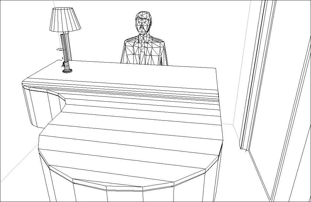

Anyone want me to convert their studio sketches to 3D?
  • Thread starter Thread starter jblaven

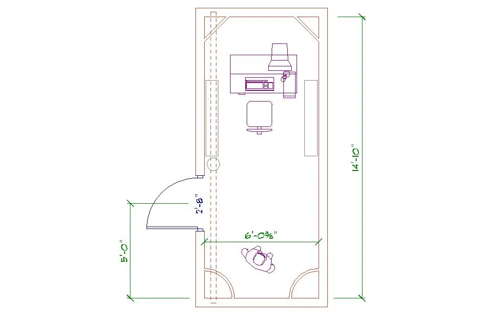

A couple of options....
Reduce the size of the desk. A standard office desk is 30" deep X 60" long. Most desks are not this large, you could use a smaller one. Is the column 4" in diameter? and if you gave an exact location of it, I could draw it in the exact place... you might pick up enough space to allow for a 48" unit instead of 36"
Joe
Re: Re: Thanks
Joe

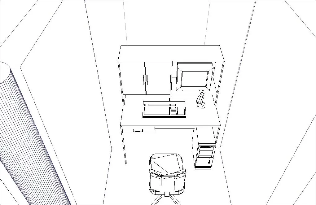

Here is the floorplan with a smaller desk. Here you have two 48" units.
Re: Re: Re: Thanks
Here is a 3D shot of the smaller desk...
hmmm
It looks like that will be my best move.
That would allow a lot of things that are cirrently a problem in the room to be resolved.
The beam actually is supported by that 4" pole which supports my livingroom floor. So as much as I would like to get rid of it, I think my wife would not appreciate the move.
Thanks again
Ryan

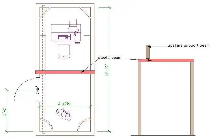

Joe - couldn't you get rid of the column this way??
cheers
john
cheers
john
Sure,
That would work. Just strengthen the walls just under the I beam. Not a problem. I was thinking about things here at work (on campus) where people start wanting to knock out support columns to "make a larger room" or because it is in the way. Nevermind the 13 floors above them. :-) Go figure. This place has my mind closed to modifying anything related to the structure... liability reasons. That's fine with me... keeps my job easy :-)

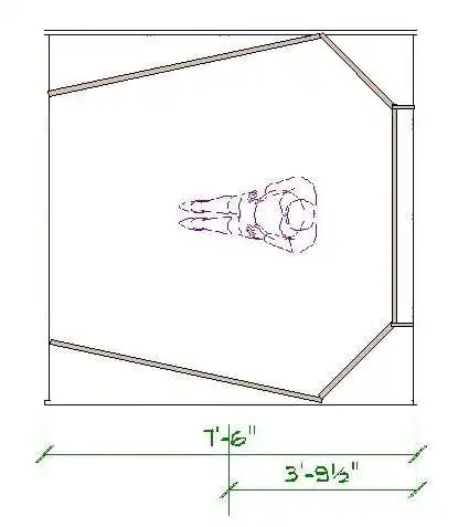

I saw your DIY wall units and was wondering if they could be used as below to make a sound box.
I know nothing about studio design, but my father and I just ordered the equipment to record his music. We want to use your Wall unit design to make a box that can be assembled and taken down.
Could this work?
Thanks,
Joe

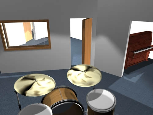

Here are a couple of renderings of Jonothon's studio...
A kind of plan view. Like the roof's been taken off.
View facing the control room...
View from control room....
Holy Shit!!!
NICE renderings!
What s/w are you using????
Wanna render mine??

Hey, it's getting nice in there, you'll have to come by sometime. By the way, interior dimensions are 50' x 25' if you want to do it to scale.
Call me if you want to visit, we're weeks away now, and it's coming out great.

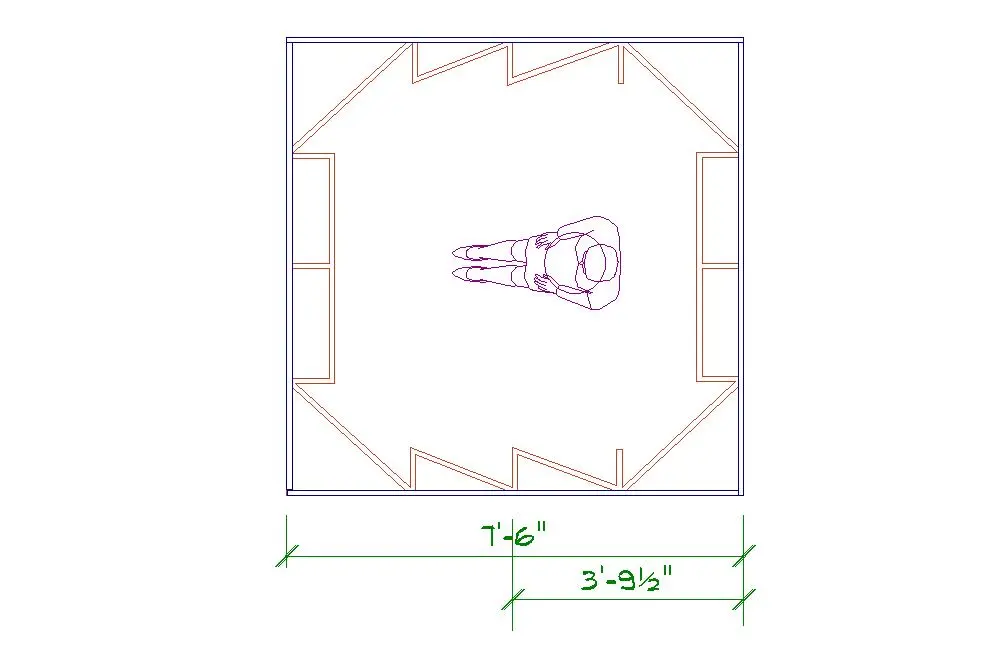

Joe - I'd do it like this with the side walls in the same treatment as the wall units I described at my site.
cheers
JOhn
