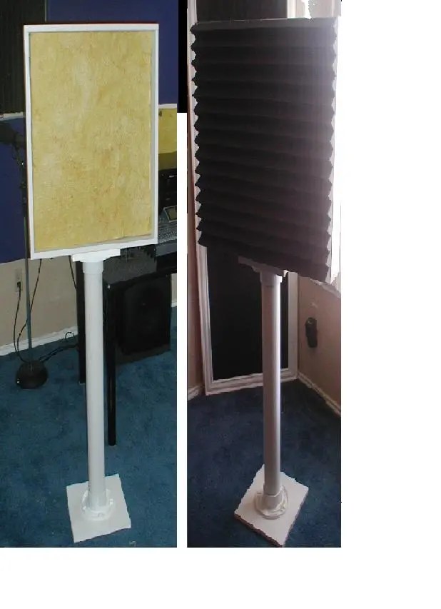

added: new use for my DIY speaker stands.... Mini E's DIY.

diy ...some 703 2x2 mobile traps for the side and window.
and hung 1qty 703/ Ethan- DIY Bass Trap to the rear wall.

clap test seems to still have a super high "ring", almost like a tapping a fork to a crstal wine glass? tiiiinnnnggg....
any inputs on that? guesses?
