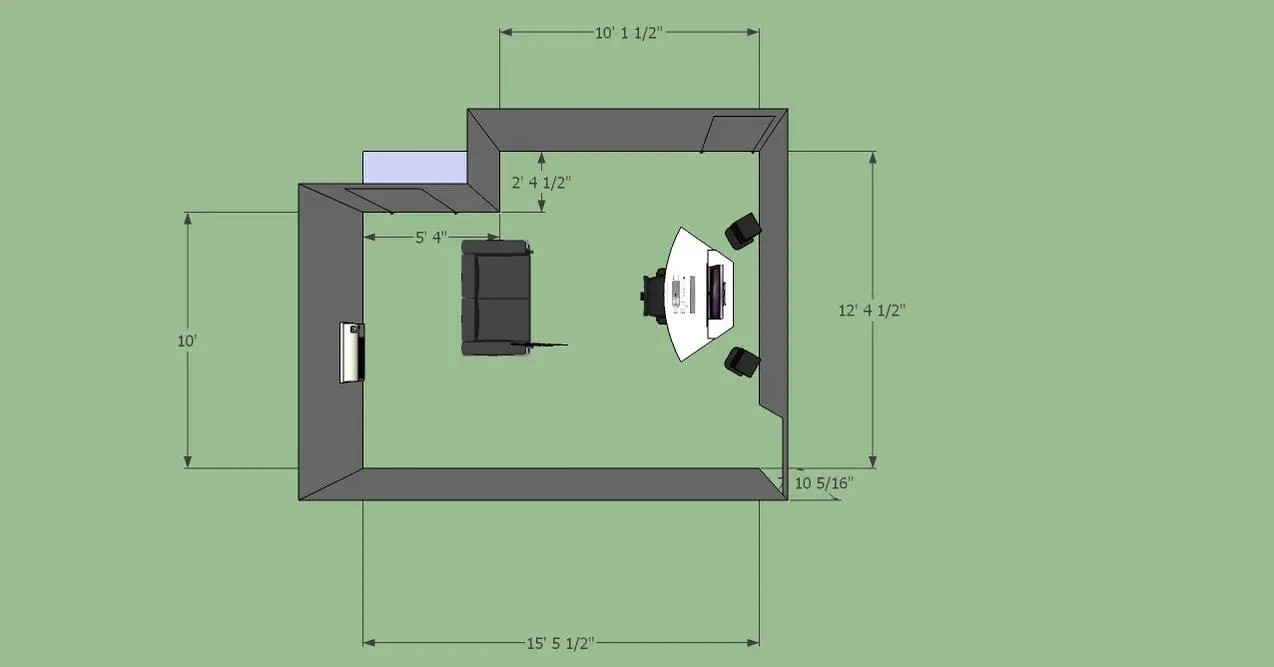

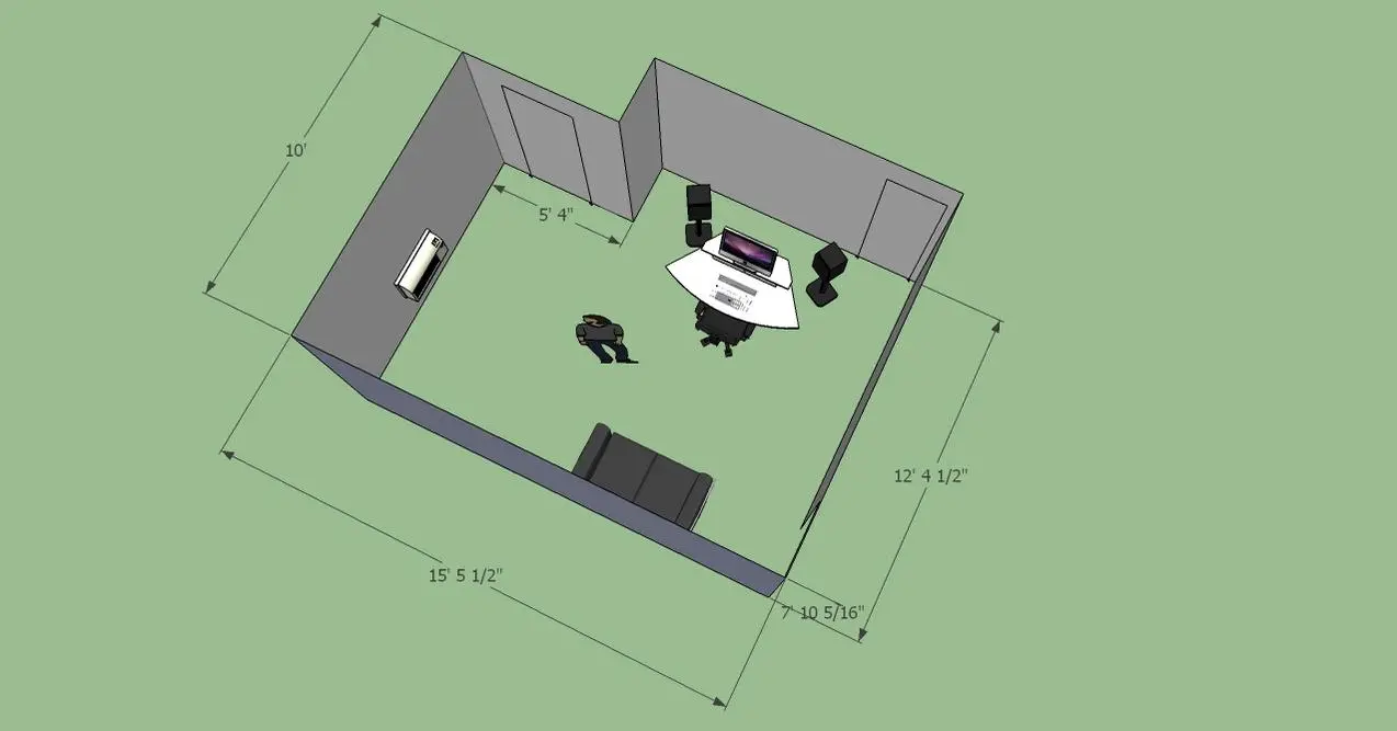

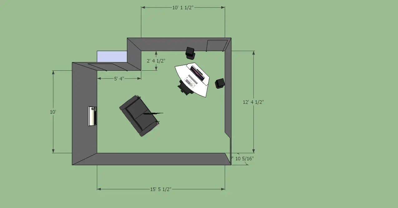

I have somewhat odd room dimensions for both places so I have posted sketchup pics at the bottom. So here goes...
The mix room now is my current layout and setup, and I have also included two mix room change pics which are possible alternative placement pics. Before I can go any further with this project I really wanted to get some advice and thoughts on the best possible placement of my desk and monitors. The monitors are 8” Event 20/20 passives. I will also be adding a small subwoofer in the near future.
In all honesty, it doesn't sound extremely bad in the room now as far as reflections go, but the bass buildup is as expected in this setup and layout. I do notice that it seems as if a lot of the reflections end up dispersing through the open door on the right or bouncing off and staying in the area where the wall ac/heater is.
By reading through many threads on this site, I know that I should try to take advantage of as much space behind me as possible, so I wanted to get some other opinions on my placement of monitors and desk.

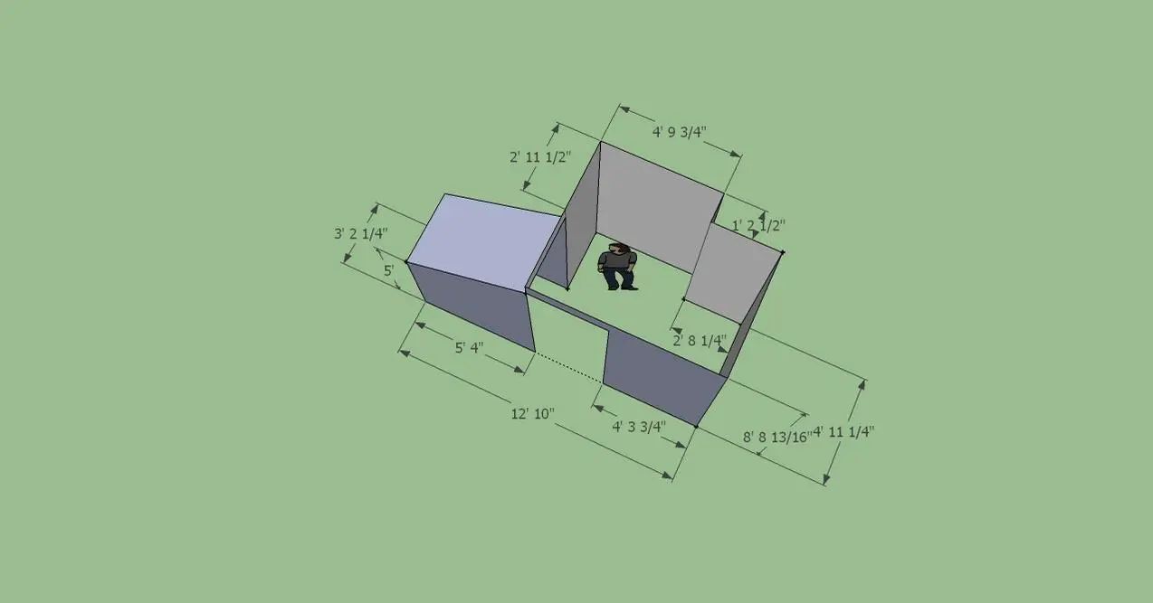

Both rooms are in the basement, and the mixing room has drop down ceilings. The vocal/instrument booth/room is extremely awkward since it is underneath the stairwell to the basement. It was supposed to be a bathroom and pantry, but there is just drywall up and you can see closed off plumbing pipes if I ever wanted to put a bathroom there. The ceiling is unfinished, as it supposed to be a drop down ceiling but the tiles are not there, so I can see the joists when I look up.
As far as treatment goes, I am pretty sure that I am going to be making broadband and bass traps for both spaces. For the mix room, I am thinking that the most direct wall and corners adjacent to it and the monitors will have at minimum 4 in flat and corner bass traps. Depending on the setup, I will also place flat 2 in broadband traps along the side and directly behind the listening position. As far as in the far left mix area where the wall heater/AC is, I am wondering if I should do a corner trap or just broadband traps there as well.
The vocal room treatment considered is primarily 2 in broadband absorbers on the majority of walls, but only to cover around 70 to 80% of each wall. The ceiling is another issue, as I am considering doing a just enclosing it with either 2 inch or 4 inch traps/absorbers. In the slanted pantry part of the vocal room, I thought it would be a good place to put the guitar amp and possibly do a superchunk in one of the corners, and then place a few panels in there as well.
Well, I hope that I have covered most of the details, but I am sure that I may have left something out. I was hoping to get some feedback on the best console and monitor placement within the mixing room, and some thoughts on proposed treatment options for both rooms.

Take the third drawing and flip the mix position 180 degrees so that you're facing the AC unit. You want the room to get larger behind you, not smaller. DO NOT FACE THE CORNER.
From there do the following:
Make sure you setup so that you’re firing down the longest dimension of the room.
Your head should be placed 38% of the way into the room, centered between the left and right walls
Your head should also be located at the tip of an equilateral triangle with your speakers. Start at a 5’ width and go from there.
Use at least 4” bass trapping in all the corners, floor to ceiling if possible.
Use 4” or 6” bass traps on the back wall; the thicker the better basically.
Use 4” panels behind the speakers on the front wall
The reflection points to the right, left and above your head can be treated with either 2” or 4” panels. I prefer 4” panels personally; you can never really overdo bass trapping.

Weasel, I have decided that I will have to keep the layout of the third drawing do to the entry doorway. Not only do I have room issues, but I have feng sui issues as well. I always feel uncomfortable with my back facing the entryway. Also I have had the living crap scared out of me while mixing some music, and then having someone come in without me seeing or notcing they were in the room :eek: - lol.
Quick question about 4" vs 6" panels in this room. After doing all of the drawups for the new layout, I originally planned to use 6" panels for the most part throughout this room, except maybe for the ceiling area and a few 2" absorbers. Should I even be bothered with anything other than 6" panels in this room?
As far as the vocal/mixing room, I am planning on using 6" panels on the back walls, and 4" in panels on the walls closest to where the vocalist will be located (where the female model is in the picture). Since there is no ceiling tiles, I am considering building a ceiling panel that will enclose the entire area of either 4" or 6" thickness. Question, should I primarily use 6" panels in this room as well?
