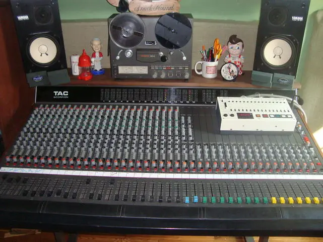

My Amek TAC Scorpion has phase reverse. You can find these for less than $1500. Mine is big (24 x 16) but there is a 16 x 8 version. I love mine. Gonna post soon about some mods I just had done to it.
