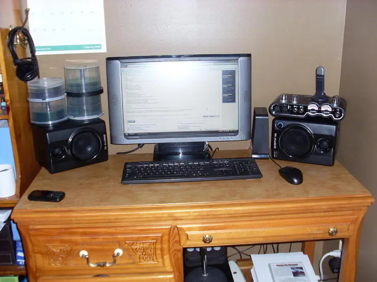

setup
This is my set up...haha pretty sad

Raise your monitors to ear level.
And put them on cement.
I use cement caps - they're approx 2" x 8" x 16" and they're made to put on the top of a cinder block wall. It stops the speaker cabs from transferring energy to whatever they're resting on. I use one layer of paper towel under the speakers so it won't scratch them.

That looks like a UX2. That's a nice interface with decent pres, you can do a lot with that thing. I think you're set there for now.
Upgrade the monitors and treat the room next before messing with any more gear. You need to be able to hear what's going on before you can tell where your gear is lacking. Looking at your gear list you'll probably need to upgrade you mics and possibly your guitar amps. You can get decent results with guitars direct through your line 6 though. Might be good to start there until you start to feel limited.
That doesn't look so bad, I've seen sadder... Everyone that already answered is spot on - I'd follow ALL that advice. Treatment is less sexy than new gear with faders and led's and knobs, but it's prolly the best improvement for the dollar u can get for now. The amp can be dirt cheap - I got a little 5w epi valve jr on craigslist for $50, it's my fav. amp in the studio by a longshot.
After that, work with what you have, figure out what your limitations are, and when you hit one, THEN upgrade something. Rack fx? DAW's have a ton of free plugins you can add, and free plugins are way better than cheap fx, in fact you have to start getting into some really nice higher end stuff before it's better than plugins. I dont use ANY rack fx in the studio.

As far as bringing the monitors to ear level- I'm going to be getting a desk soon hopefully but if I brought concrete caps into my condo and threw em on my fiance's childhood desk, I could kiss all of my equipment goodbye. ha
Working on finishing my basement and all of these great tips will be incorporated. Yes I have been quite impressed by my ux2 and the quality of the preamp effects and I have been using Ozone 4 for my mastering and those plugins are pretty kickass... I think maybe I have been suckered in to believing that more is better, and the impressive look of a stack of rack effects would be nice... I think i was reading into the rack effects more than i needed to..
Send a track out of your PC, through the rack, back into your PC and re-record the effected signal
wow that made it black and white. ha
as far as getting the desk out of the corner... will do
and consider the gear sold. im going to look for a good tube amp.
