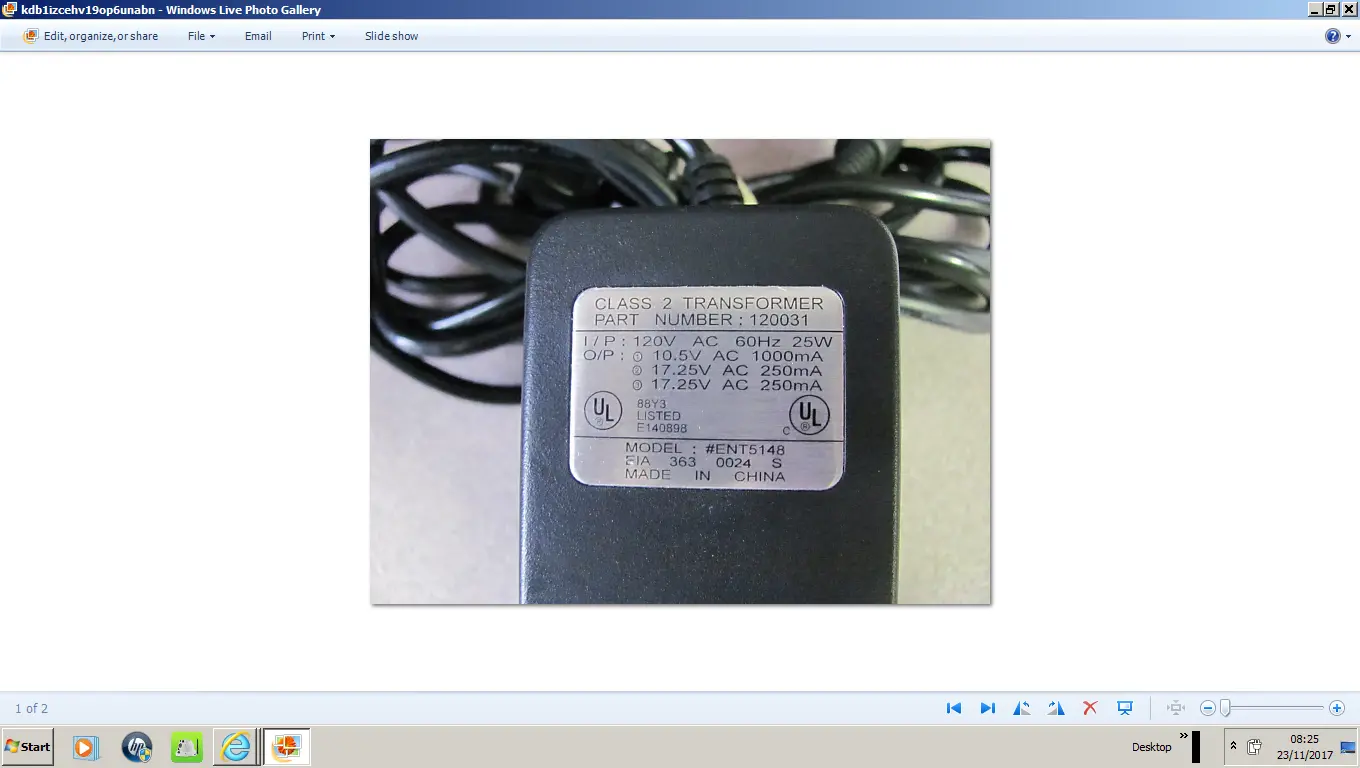

after a couple of cross-country moves, I find my trusty old Antares AMM-1 missing it's power adapter. Anyone know the pin-out of the power socket ? It requires 10.5VAC and 17VAC X 2 (I think). If you have an old hardware version of this unit... could you measure the voltages on the male plug from the power adapter?

Does attached help? It seems 10.5V is on pin 1 referenced to pin 2 and 17V on pin 3 ref 2?
This is just a guess though and destruction could follow if wrong. I have posted the problem at SoS forum. In the meantime I would look for a couple of 7 pin DIN plugs AND a 7 pin socket, makes cobbling and testing a gash supply easier and safer.
BTW I would think 9V AC and 18V AC would be close enough since finding rats with those exact voltages will be tricky.
