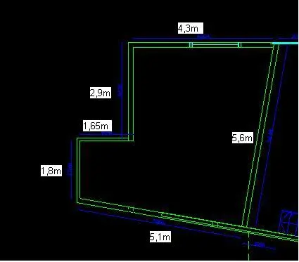

Dear all:
After several discussions with my wife and arquitect y acheived the following area for my studio.
My main objective is to have a control and a live room.
I think the control room should be in the lower-left corner but I dont knowhow to arrange the layout of the console, monitors, etc and the total area that the control room should have without leaving the live room too small.
Any suggestion will be very wellcome
Thank you all on advanced

That lower left corner is pretty small, tough to use that as part of a control room because it would be difficult to maintain symmetry. Instead I'd just make it a little vocal booth, and concentrate on the main room.
You'll end up with dimensions similar to Ethan's design here:
http://www.realtraps.com/art_studio.htm
