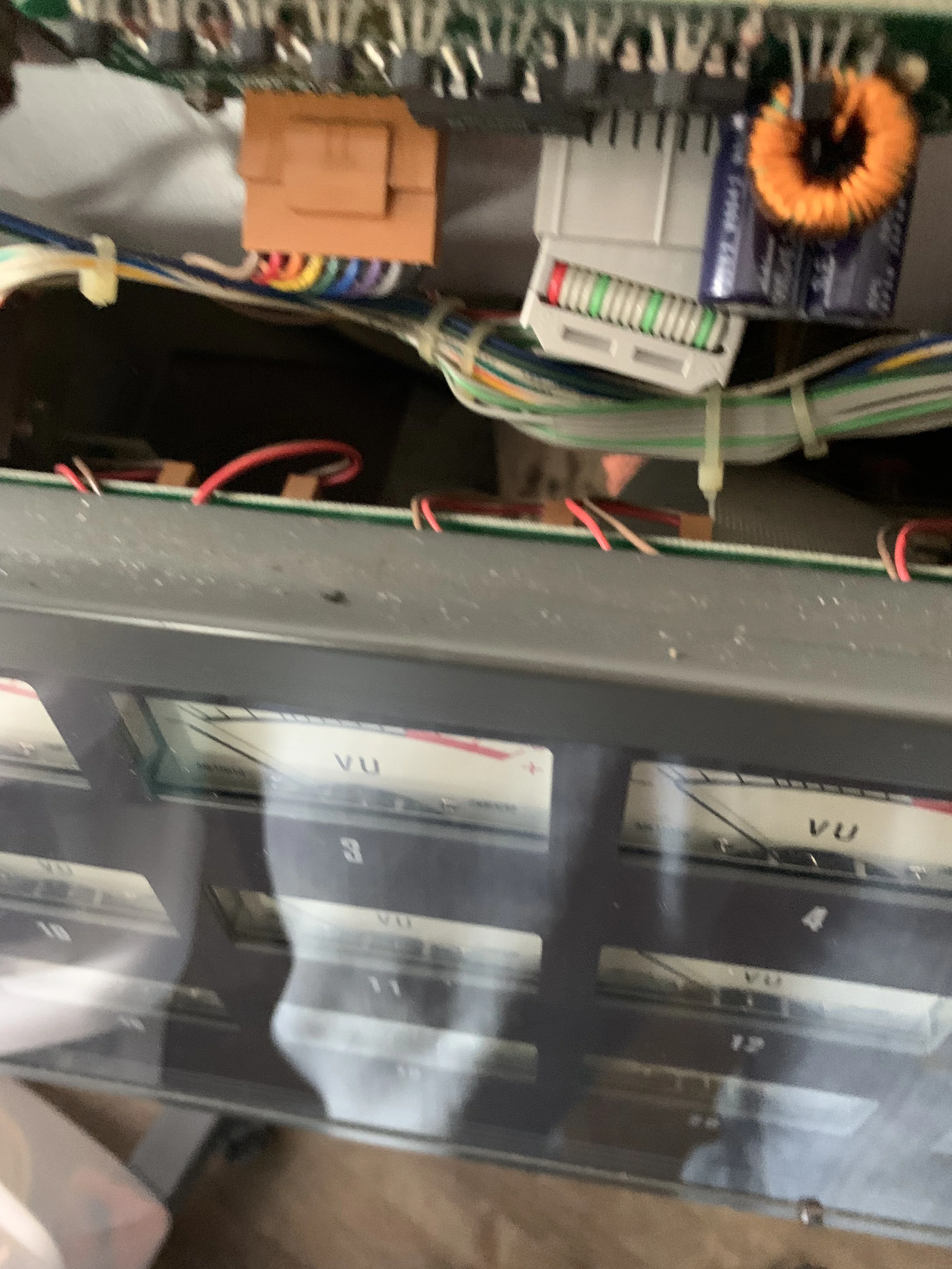

- all indications unit is recording - meter movement headset monitoring input - on play nothing - no meter movment or audio

Thanks! Ran the calibration tape and repro sync all channels playback successful. While running I saw a brief output. Did some digging maybe transport control issue.
opened panel and found a loose connection and I think I did it. During cleaning I loosened this panel and caused the cable to loosen up. On to the next issue - thank you
See cable on the right
