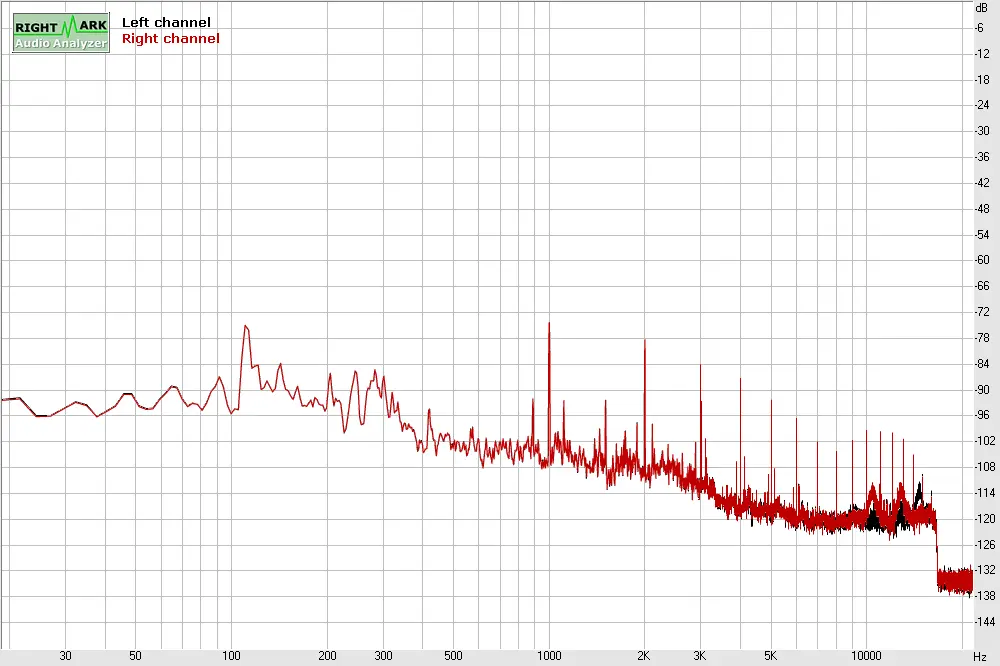

Oddly the spectrum of the buzz shows no 60Hz mains but a bit at 120Hz so that is poor DC rail filtering. Then you have a nasty spike at 1kHz and a decaying sequence at every harmonic onward.

I suspect that noise is in fact the a-to-d converter in the mixer.
